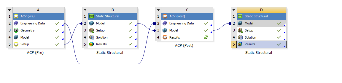

A few days before i have posted my doubt, fatigue tool is not solving when it is connected to acp module. Now i have done the workflow as shown in the above picture and the fatigue tool is working now....now i have two things to ask...
1) Is this workflow correct?
2)in the second picture it is showing some error which i couldnt understand..coz i have completed meshing in the previous step of acp post..
So any one please look on to this, a provide suggestion to this problem...
also the second static structual i am not able to view the imported plies...
but the material it is taking is GFRP.
please help me..
with regards
