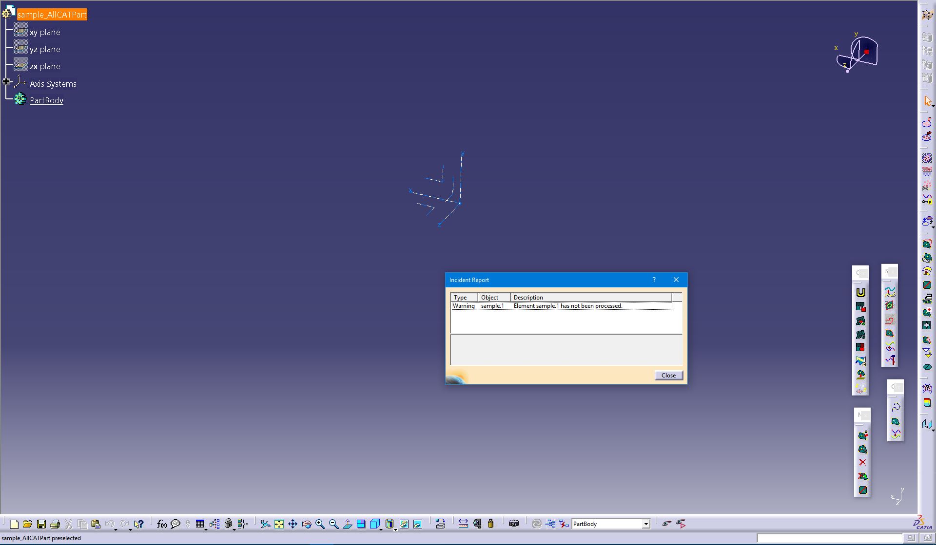

Good day!
I'm now working for converting the .stl file to igs and step.
But i cannot complete my task because of some "topological error"
Is there anyone who encounter this problem? Or have an idea how to solve this one?
Thank you very much.
This is when i import it in digitized shape editor, it can't recognized as a body. I can't make it solid. How am I suppose to do? Thank you very much.

Thank you for the reply Sir. Unfortunately, i can't open this stl file in the Part Design.
I'm not familiar with Digitized Shape Editor Sir, but this is the one only that can open my stl file. And also in the assembly I can add it as an existing component, but sadly i can't generate a CATPart.

On your 3rd picture you have imported stl mesh inside Part.
Use to generate necessary sections for reference and measuring.
Then go to Part Design Workbench and use Sketches and Features (Pads, Pockets, Ribs, Filets, etc...) to recreate 3D model.
You can't get B-Rep CATIA 3D model automatically. You must make 3D model using stl mesh only as reference.
