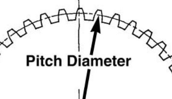

I've searched for tutorials but all the problem is there is no base circle diameter given that's why I'm having problem.
Hi,
want to help you, OD is the outer diameter therefore (OD=16.51mm)
while PCD or pitch circle diameter = 15.24mm
Hope this might help you. Enjoy
Thanks for the help๐
What do you mean it's not complete. There are dimensions that you can figure out.
There is no dimension for the gear profile. how you will calculate then.
Even the PCD and module is the minimum requirement to design a gear teeth.
So base circle diameter is Difference in pitch circle diameter and 2.5* module.
