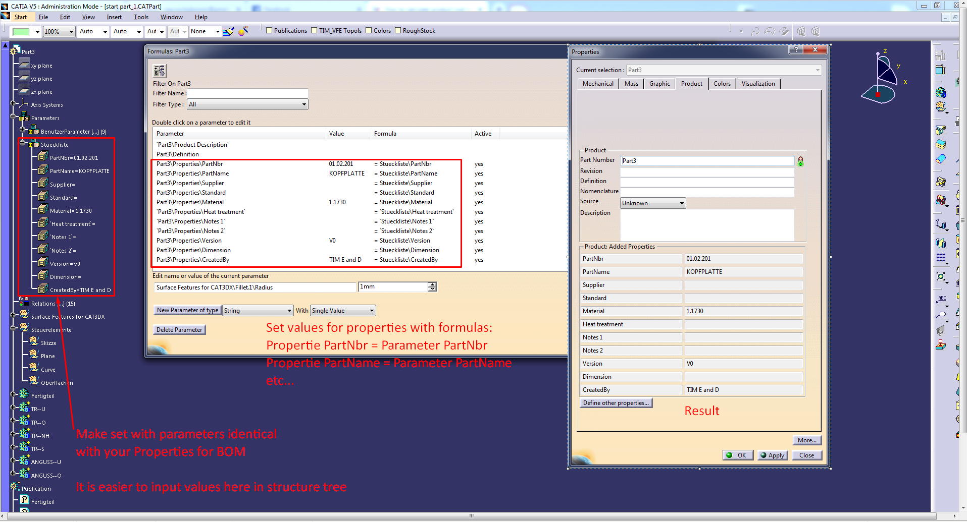

Sorry, Carl Brown, your answer is just a DYI work-around-method. In a professional way you use “Define other properties” to create several additional fields like “Cost raw material”, “Cost drilling per hole”, “Cost cutting”, Cost painting”, “Cost assembly”, and more, depending on the kind of part, function, industry....And all this detail information must be filled in and kept up-to-date during the design process. If you than extract a BOM into excel with this information, than you will have part of the cost of a product. Additional cost may be documentation, certification, shipping, after-sales, quarantine, extra labor....

I agree, thanks for pointing that out. He should be able to use the same directions as mentioned, but use that Define other Properties instead so he is able to add those other costs accordingly.

Please find on picture below tip for easier edit of Properties via Parameters in specification tree. Ofc, you need to make this on your "start part" (template) and use it later with File/New From for all of your CATParts in project.
