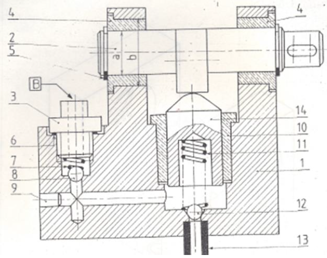

Hello,
Its a volumetric circulation pump with inlet in load: 13 is the inlet hose, 12 is the inlet non-return valve, 14 the metering piston, 2 its actuating cam shaft, 8 is the output non-return valve, 3 is the output connector of the Pump...
do you have other picture design technic of this pump ?
