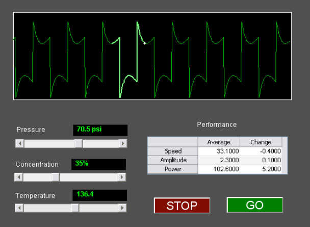

Maybe I should make my situation and question clearer.
My C & C++ programming is not bad OK.
I normally work with STM32 M3 cortex usually maple mini and Atmega such as Arduino mini or pro simply to make projects and prototype development cheaper. I integrate these with my normal electronics circuit design work.
I use the Arduino interface for most of my programming simply because I find it easy and fast. However I am now evolving over to mbed or Keil for more in depth and faster MCU project development.
I have been using QT to design GUI interfaces and control MCU's by serial communication although I found this software has a heavy price tag and is time consuming with poor support that I need to look for alternatives.
I have been considering looking at GTK or even others like matlab that do not have such heavy restrictions or price tags attached.
I need to make custom PC GUI windows with pre programmed buttons that then control the MCU of choice via a direct serial port or other connection. Custom PC GUI windows example picture below. I need to then turn these in to a standalone exe program that can be put on a disk or stick then uploaded and used on anyone's computer.
