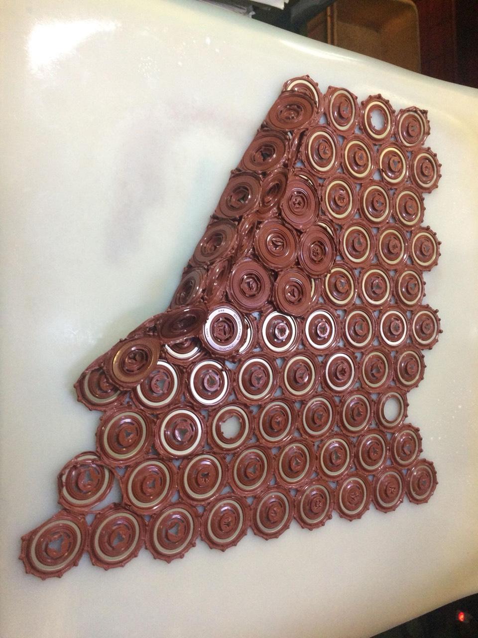

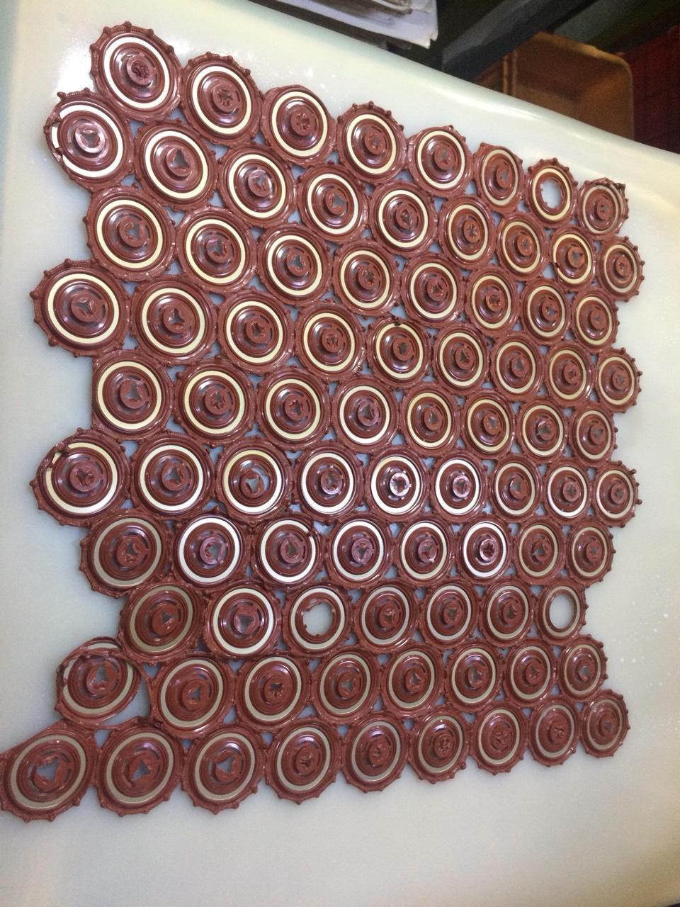

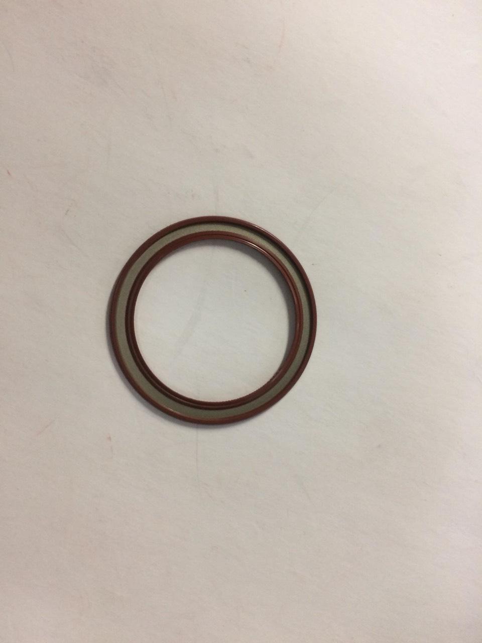

I would like a mechanism for eliminating the innermost and outermost rings so that the end product is a seal
Hi Nhut,
Check this link, may be useful to build a machine for deburring rubber parts, you can use dry ice blasting as a basic concept
http://nitrofreeze.com/when-to-use-dry-ice-blasting-for-parts-finishing/
