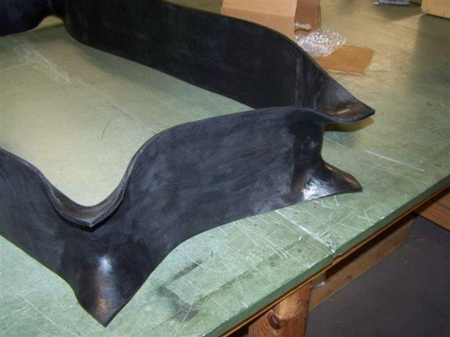

I am having a hard time drawing the exact shape that you see on the attach photo. It does not have to be to any scale.

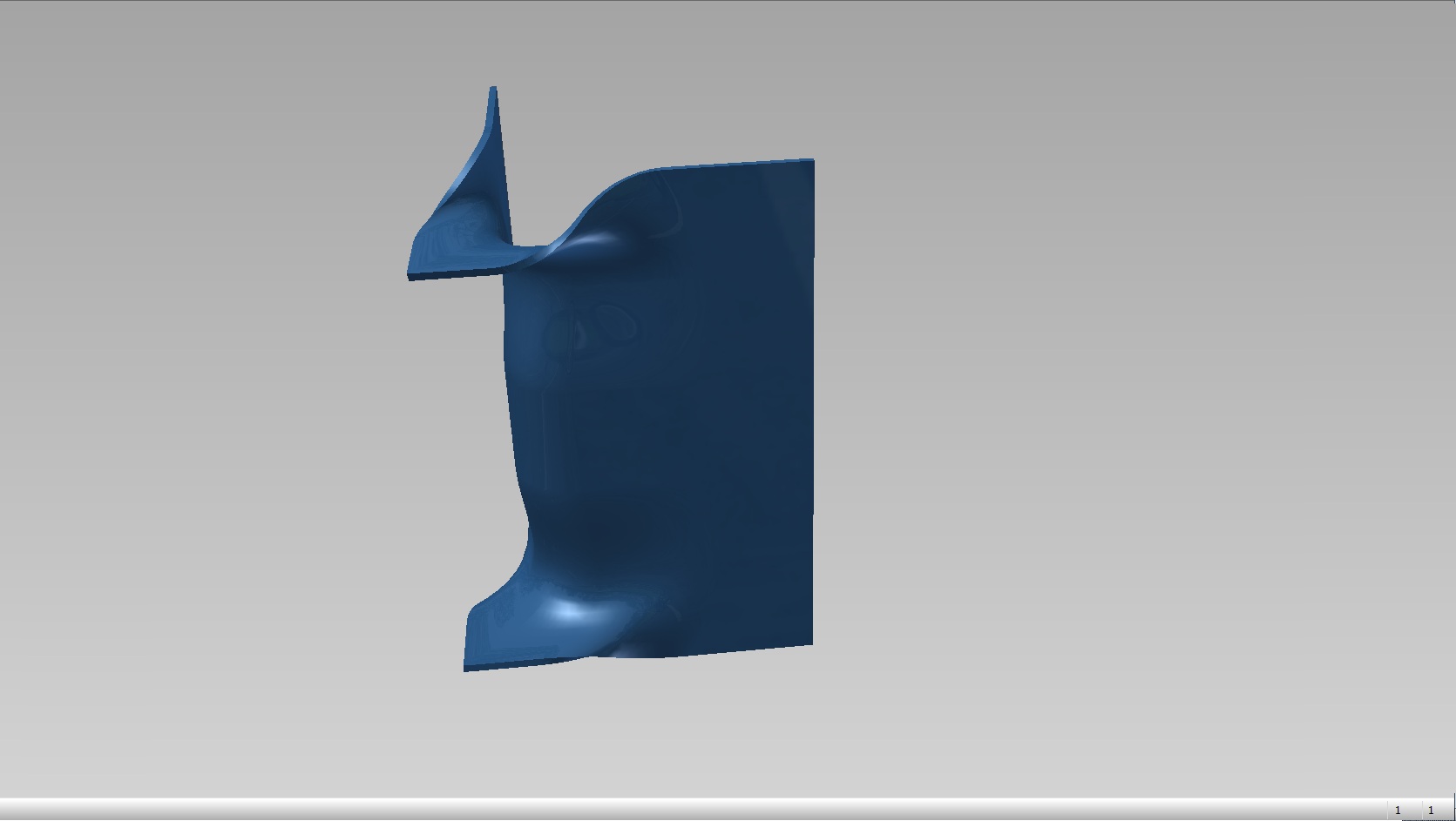

This is how far I am.

Regarding my attempt I have met some small issues while I was designing the above model...
Let's say for example the square shape works fine (Pic-1) until you will go through the rectangular. Then you start having some uneven contours using the loft command & I don't really know why!!! ;P
However, as it is not a big deal a side path is to cut a quarter of your model (Pic-2) and then with the "Move face" & "Mirror" to rebuild the model in whatever dimensions you want to!!! I hope to make sense.
So, find attached some pictures and if you think that you are wasting too much time on a model that it doesn't worth it (It happens to me very often) let me know to upload the model !!!
