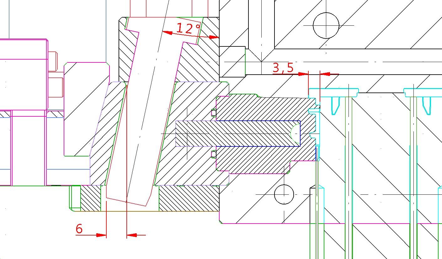

Friends, i really confusing to design a slider by using finger cam mechanism. please, anyone provide a simple calculations of slider with respective images. please also provide some complete slider mold design, if possible

Sorry for the delay.
Well, let's say you have an undercut with 3,5mm as this picture shows. Here I calculated a movement of 6mm to avoid any problem with the extraction. This calculation is easily made measuring the X distance from the vertex of the slide hole to the end of the cam pin. In this case, 6mm... If you need a higher opening value, you can increase the cam pin, always measuring this 2 points, adjusting everything else to your needs. I hope it is clear to you. Surely there are other methods to calculate, but i personally think this is the easier one.
