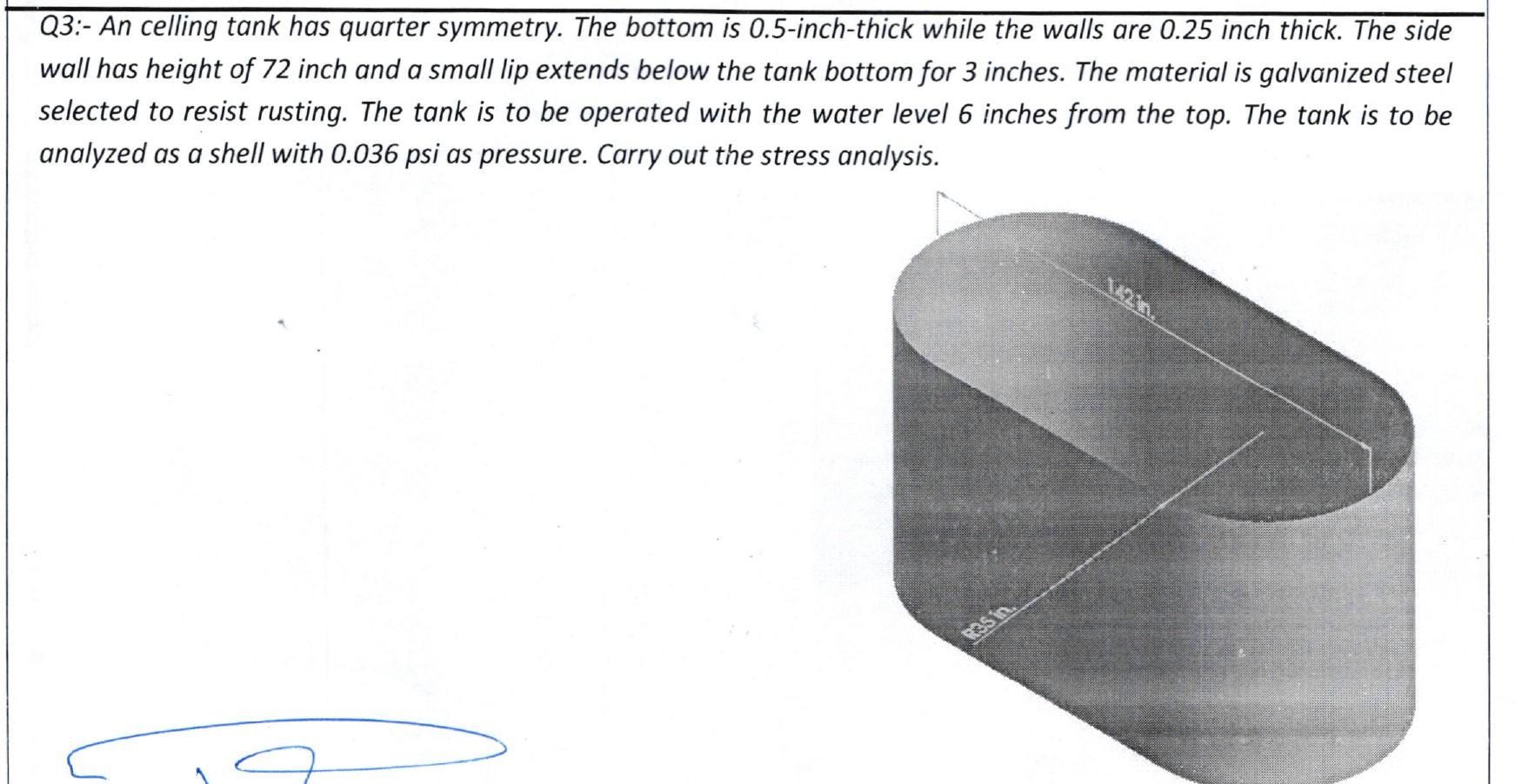

Hi ... can anyone help me in solidworks simulation plase
I'm a student and i need to know how to draw this example in Solidworks simulation 2016 or less 2015 ....
2 Answer
I can create the object for you but I can't simulate it for you.
1. The way to sketch it is to draw a box and then and radius the corners to a full half circle. - OR- you can just draw an oval using the oval tool.
2. dimension the length and width of the oval in the sketch.
3. create an offset to the wall thickness
4. extrude all of the sketch up to the bottom wall thickness.
5. extrude just the otter perimeter up to the top height.
6. Use can also user the shell tool on the full extrude if you would prefer.
Did any of these steps work for you ?
Also please post which software you are using for the pressure simulation as SolidWorks has very limited capabilities without the extra modules, especially in the student versions.
