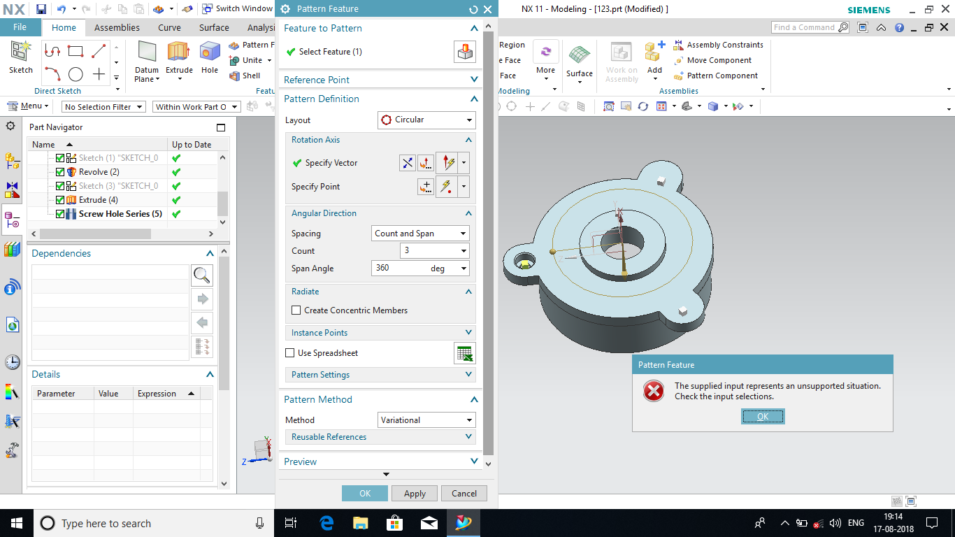

you have to use pattern feature option.
Thanks and please correct me if any suggestion.
yes can be pattern, can use 4 method use.
method 1: normal pattern (circular/ rectangular)
method 2: synchronous pattern (circular/rectangular)
method 3: instance geometry
method 4: move object
depends on you which method u eazy to use.
just click scale command =>select the object => click the fixed point => type the value => ok
yeah tried with some corrections its working..thanks for your response dudes..
yes the similar way to what ratio you need you can scale
thanks buddy hearing some new terms which I havent used 3.instance geometry..gona try those..
