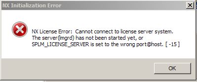

Did u change server name in license file? and copy paste all files in right path?
what is must be name server?
You should set your environement variables to the path of your license file.
Do you use a wifi dongle as license dongle?
does not use
the name of your computer will be your server name. right click on the my computer open the property. check the full computer name here and copy it, then open the license file in note pad paste it on 1st row license server place.
