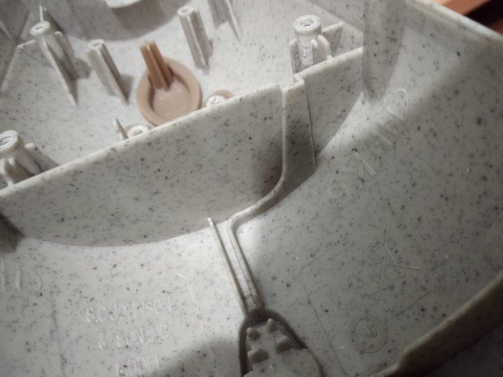

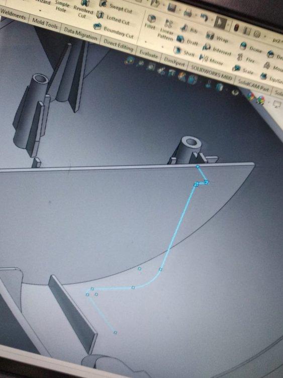

3b sketch to create a solid model here, I followed the path to shape the shape of the rib, but does not recognize the rib sketch extruded process does not recognize the sketch is not doing the reason?
I made a sketch with composite curve but the problem is exactly the same
surface extruded process I tried to find a solution how the room was not?

You can't extrude a 3d sketch. Extrude the surface from a 2d profile sketch and trim it to correct geometry with 2d sketches and the bottom face, then thicken to solid body.
I drew a profile from above and cut the figure from this profile

I can't tell from the first image above how, or if that little bump out connects again to the main rib.
I think the easiest manner to make this would be by making another rib (with the rib tool), then trimming away the undesired parts.
If you post a sample model with some of this geometry in it, we can try different things. I don't have time tonight to try and recreate all the base features to get to a testing point for the rib.
Okay, yes you can extrude some 3d sketches in some directions, but it is not a robust approach because of the high risk of failure. The 3d sketch shown above has 3 orthogonal sections that will fail due to self-intersection when extruded along any of the major axes, and those are the axes that you want the geometry to follow here...
I agree that trying to extrude the proposed 3D sketch would be a disaster. I only pointed out the possibility of now extruding a 3D sketch for completeness. I had not heard of such capability until I encountered the above mentioned helmet.
I made this example tonight as a test. It seems to work well. I think your method of extruding will work well too. I only used the rib tool since it looks like everything in the model will have draft for injection molding.
