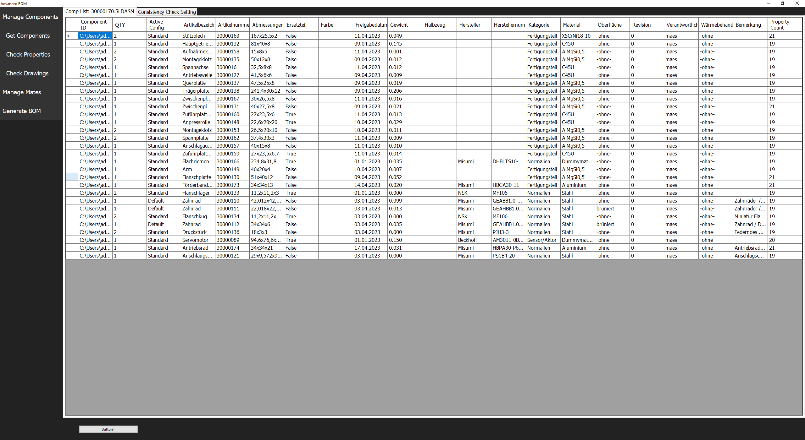

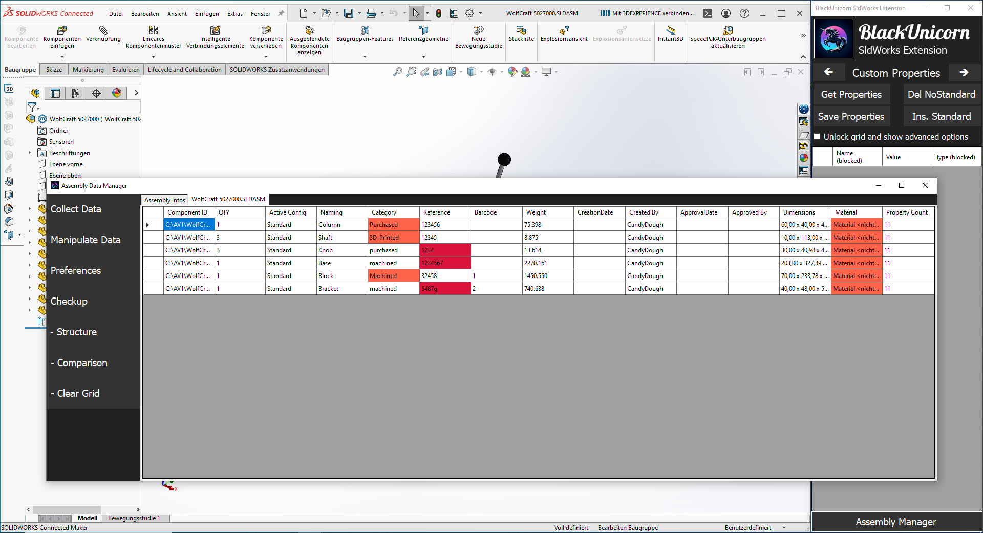

I'm working with SolidWorks for several years now, mostly in smb's. Most of them couldn't or did not want to afford a PDM or ERP System. So, a lot things had to be done manually. When I discovered the SldWorks API it was mind blowing to me, what could possibly be automated. There had been so much time-wasting processes like exporting into neutral formats like stp, pdf and dxf or checking custom properties for consistency. To straight up some of These processes, I developed a little "SldWorks Extension" which allows some good time savings. Since I used it just by myself (or my colleagues) most parts are not stable and need to be revised. So, I did this for the first functionality and I'm going to share it with you.

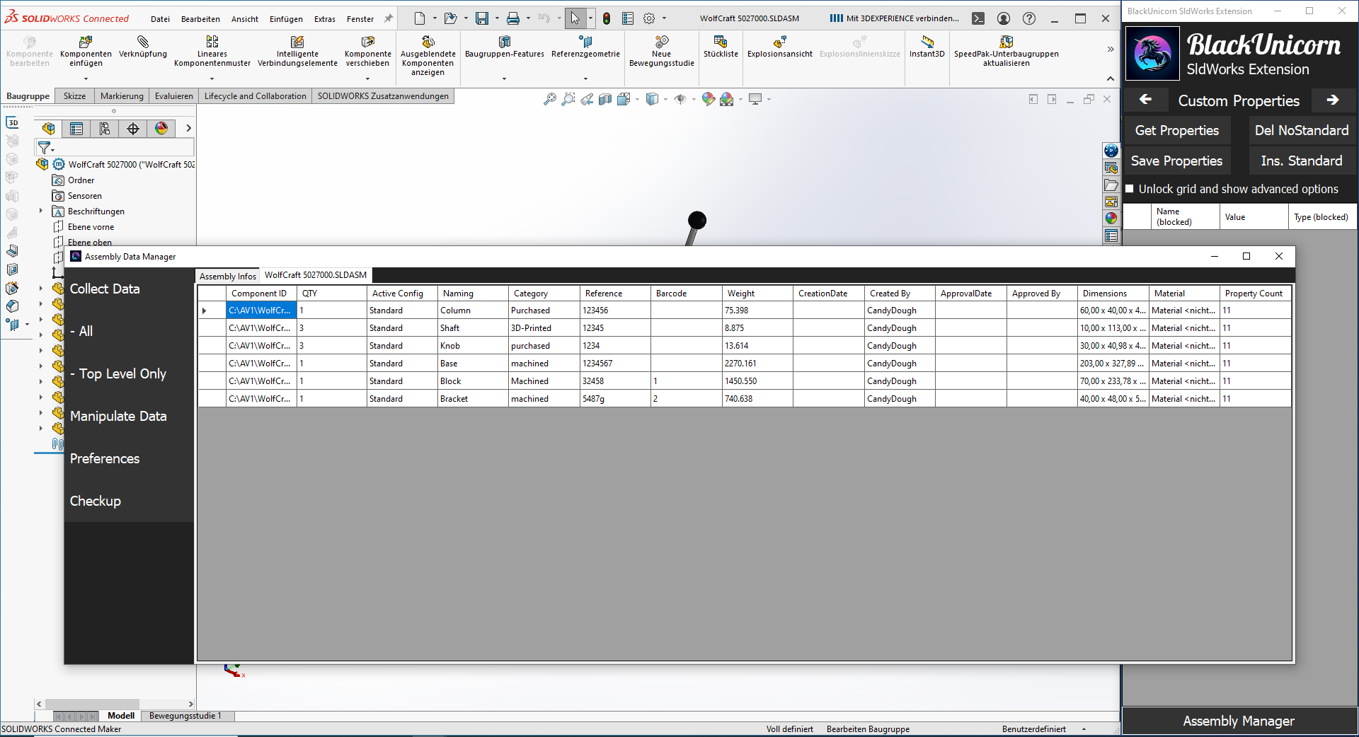

The first app version will simply list all your documents and exports them in neutral formats by your choice. If you use the tool in an Assembly document, it will list all components of the assembly and the subassemblies. So, let's say you want to Export an entire machine including all associated drawing documents, it will do it for every component document you selected in the file grid.
There are some conditions your document structure needs to fulfil:
  • Drawing documents must be named as the prt or asm documents and be saved in the same directory -> prt1.sldprt / prt1.slddrw
  • The exported files will be saved in the same Directory as the document is saved -> I'm working on custom settings in future Version
  • Supported formats for 3D documents are -> stp, jpg (hides the design tree; rotates to isometric view; zooms to fit; generates jpeg; brings back the design tree)
  • Supported formats for drawing documents are -> stp, dxf (working on custom settings here, too)
