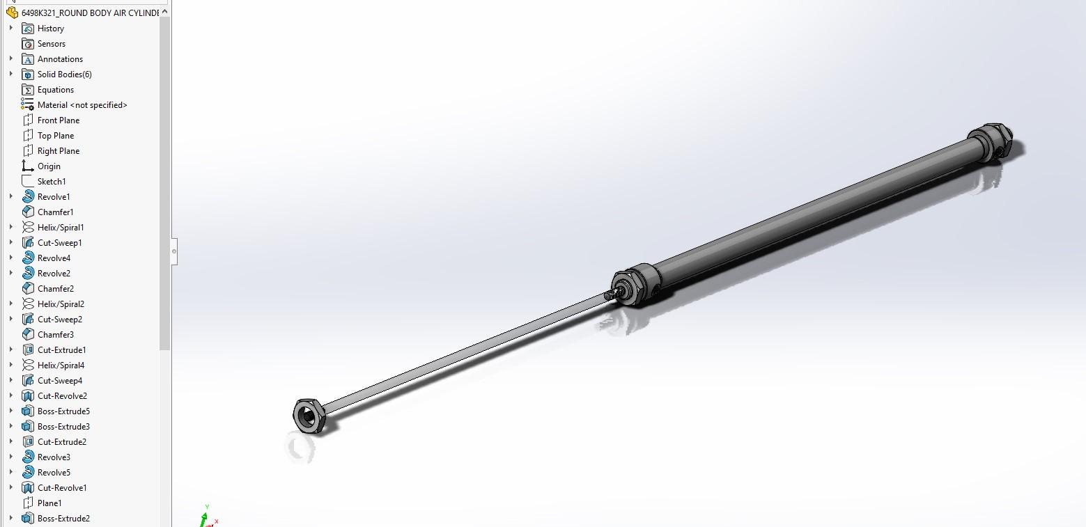

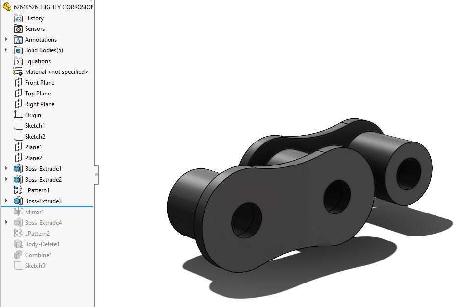

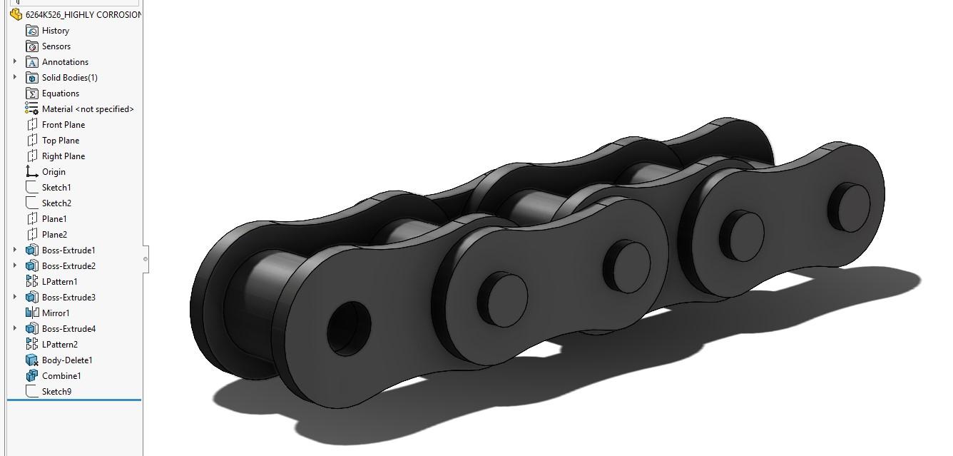

McMaster-Carr is the best place to download real hardware and also learn new techniques in respective CAD software by reverse modeling. https://www.mcmaster.com/

I was merely stating the fact that it is a good learning tool to see how pros model when you are just starting out in 3D CAD. Even if it is just modeled hardware (nuts and bolts). Also faster to model or design the custom components in the assemblies when you don't have to model the little details (hardware - nuts, bolts, chains, cylinders).
NOPE, Fasteners, gears ....
go take a break and take a look at what they have.

Yes and no. They have solid models for the vast majority of their products but many of their models are much too detailed for normal use in designs. That’s especially true for their hardware. For small assemblies it doesn’t make much difference. But when you’re working with large assemblies with 10s of thousand of fasteners and a myriad of other parts, correct simplified representations is important.
Unless you are 3D printing the threads of a fastener (unlikely), actually modeling the threads of any part is superfluous detail that wastes computer resources. It shows up incorrectly on detail drawings. It’s difficult to automatically annotate, etc. Fully modeling threads is bad design practice that should be avoided unless your purpose in doing so is just making pretty renderings or 3D printed parts. And in most cases, the graphical representation that most CAD systems provide is indistinguishable from fully modeled threads except in very close up views.
McMaster Carr is my go to source for a great many components along with their solid models.
In most cases it is NOT a good place to learn techniques by reverse engineering.
