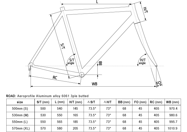

Hey buddies i need a dimensional drawing for designing a bycle in Solidworks
Kindly share it here or mail me at

I did find this bicycle print:

Is there any mathematical formula for finding length of top tube, bottom tube, seat tube, etc.?
If you look in many bicycle brands websites, after choosing a bicycle model, for sure you'll find images like the one posted by Serhiy.
I'll leave you with some examples.
https://www.trekbikes.com/us/en_US/bikes/road-bikes/performance-road/domane/domane-al/domane-al-2/p/23522/?colorCode=black - scroll down the page
https://www.scott-sports.com/gb/en/product/scott-scale-920-bike?article=265210008 - click on "geometry"
Etc...
Although you can't use all the measurements they provide, otherwise your sketch will be over constrained. Use first the most important measurements like stack, reach, bb drop, angles of head tube and seat tube, ...
