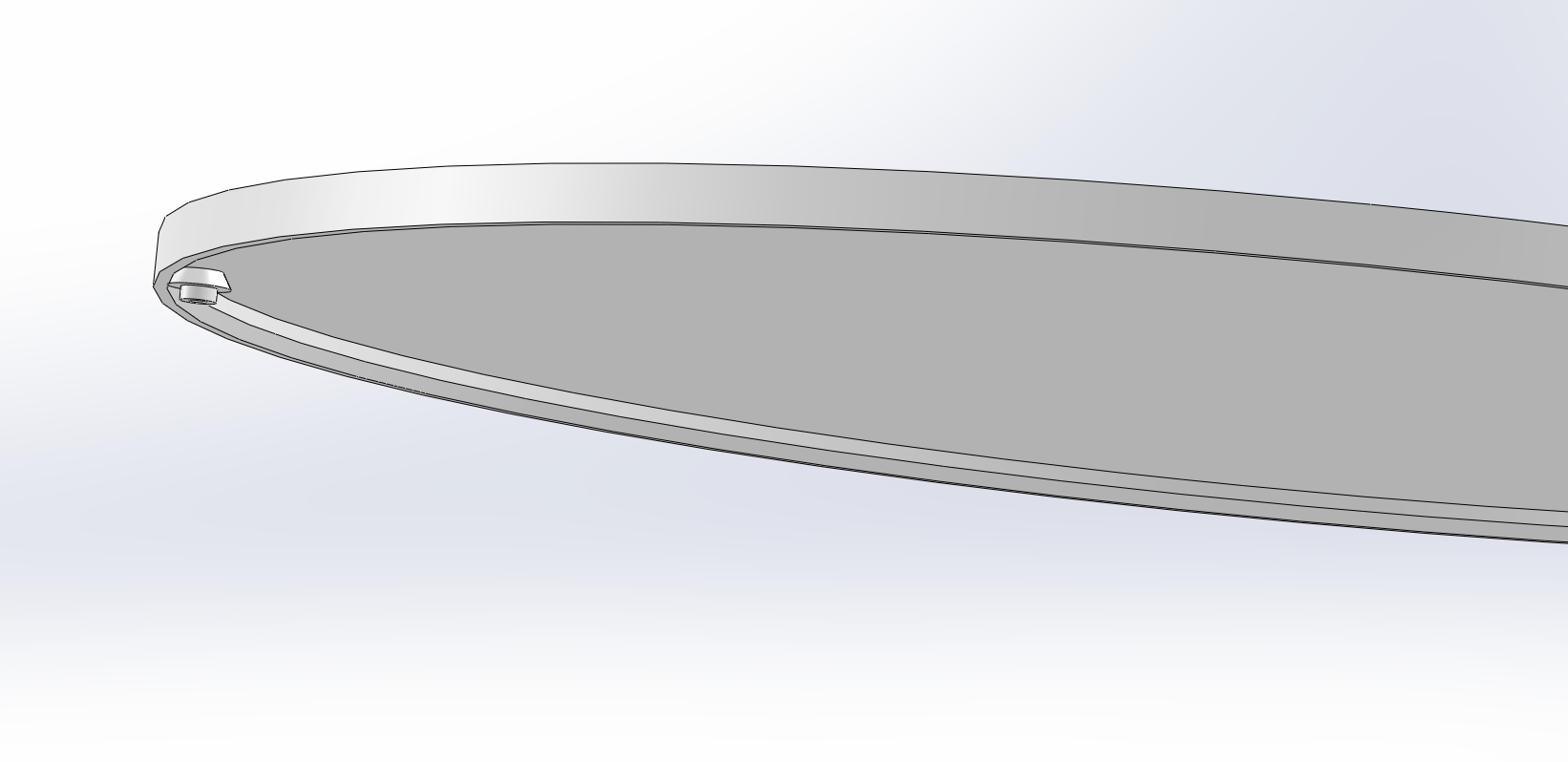

I've tried to use this before on a design that I was working on, but it didn't have the ability to handle the particular situation that I have.
Maybe someone knows how to find a workaround for this.
What I was trying to do is a kind of a round plate, which would have gear teeth on the inner side of its perimeter, and a small gear at 90degrees below it, to drive it.
It's sort of like a spur gear, but not any of the possible arrangements geartrax proposes, so I couldn't get what I needed out of it.
Anyone has any ideas about that?
I drew up a quick ultra simplified representation of the situation, with a large round plate and a small angled spur gear to drive it from below (attached).
The type of small angled gear that I'd use looks like this one:
This small gear would not be metal probably, but rather be made by plastic injection, and would go on a DC motor with a 4mm axle.

While I understand what you want is to generate a gear with internal teeth, for that you have to select the option (internal gear) type of gear, check the image there is the option. GOOD LUCK
Would this work for a tiny angled spur gear like I posted a picture of?

in the following days I have been trying to find some solution to your problem,
for now I have not managed GEARTRAX, I can do it,
for now the only suggestion I believe is that you first do the angled bevel gear and
try to create the gear with internal teeth externally or rather in context
to the bevel gear, for now it is the only suggestion if later I find a better solution you notice
