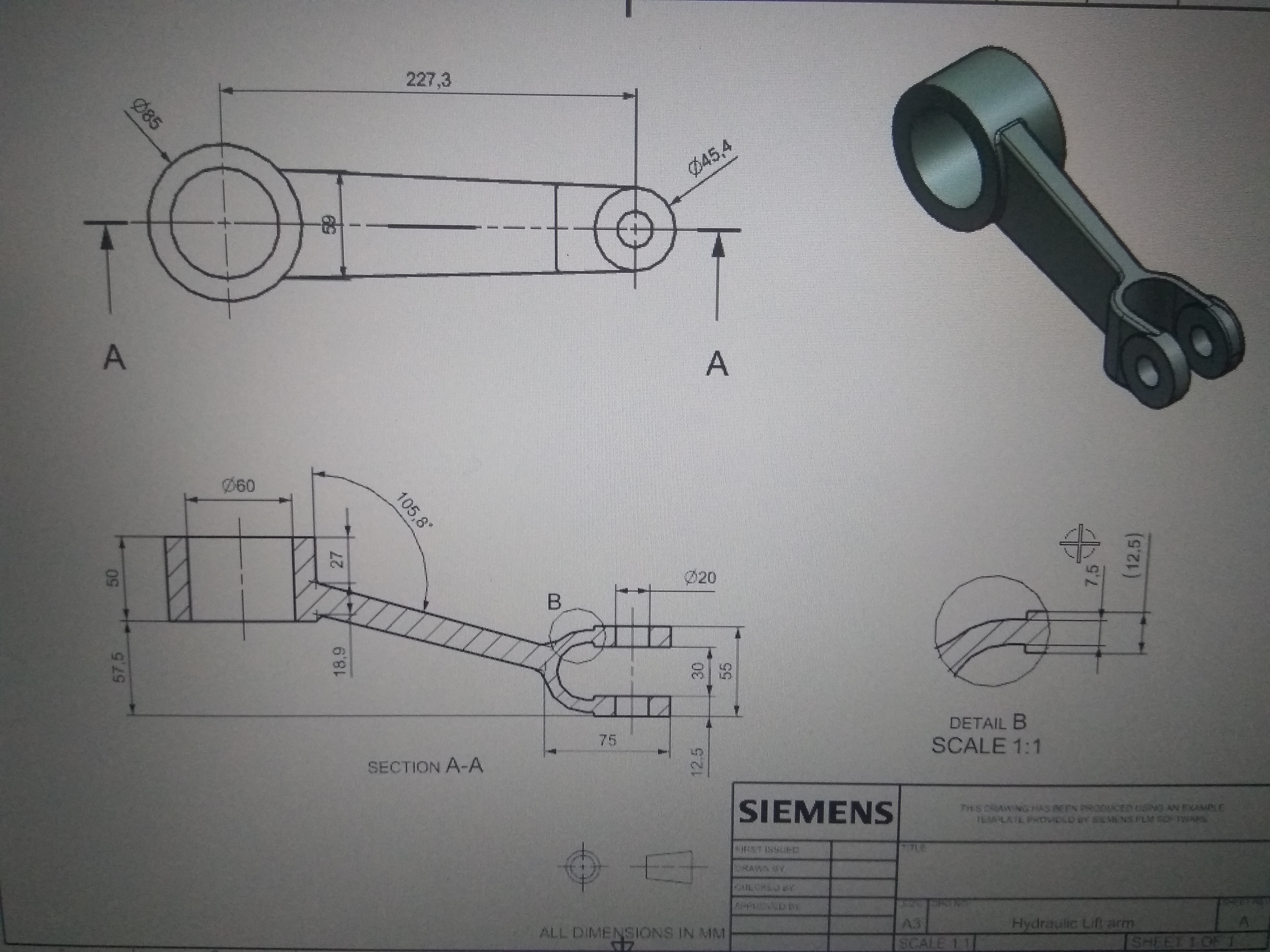

If you could tell what you want to know , like wrong in what aspect ??
dimensioning approach or placement
Seems ok to me , he just took front view and its section view to explain in third angle projection.
Thank you so much brother for clearing my doubt.

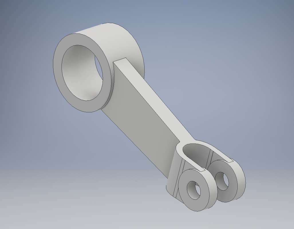

Im trying to make the model now, and these are some of the measurements i would mark. Especially the outer radius.

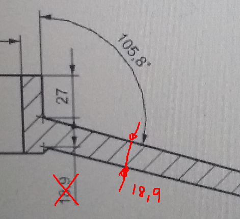

IMHO your have low dimensioned the fork in the detail. A good practice is to place only dimensions that can be measured during part production whithout calculations.
All of the Fillets seems to be missing
And perhaps move this measurement. Then i know that the lines are parallel, and its easier to model.
Thank you Logio logio
Please can you tell me. Is there any way or rule to check if drawing is fully dimensioned?
Designing it is the only way...
Here is what your drawing comes out as. All the measurements for the smooth edges are missing.
He meant the fillets of the outer sides of the side...
