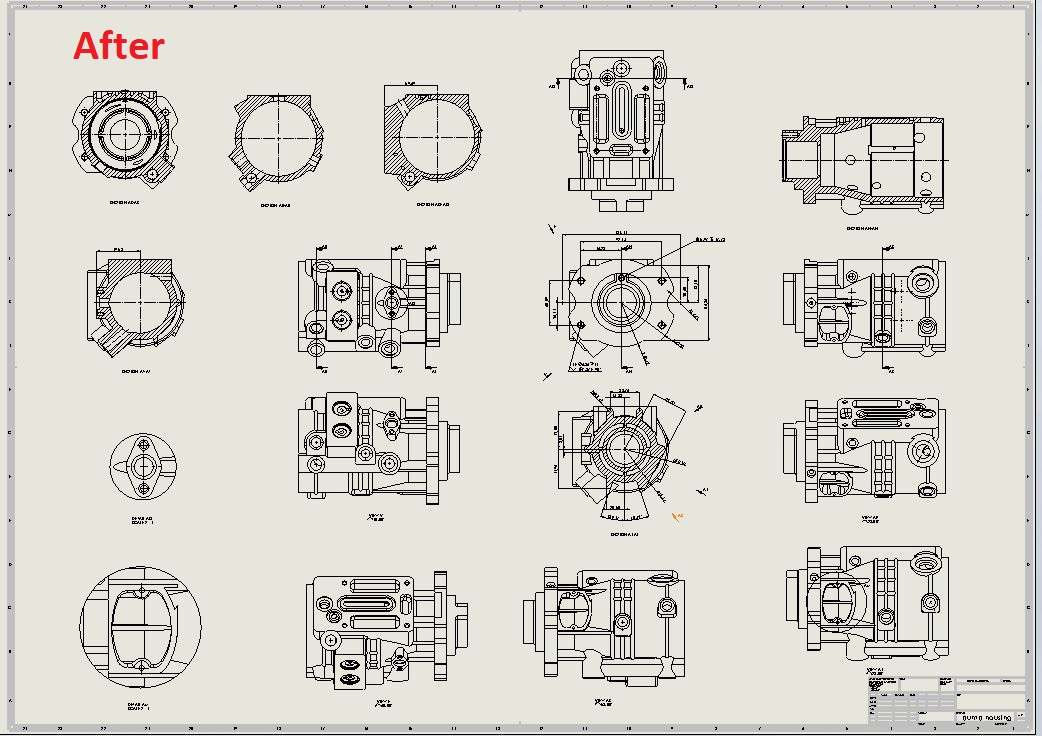

which one is a good practice to dimension a part like given below?
orange dimension vs. red
auxiliary view?

It would be difficult to place the normal/auxiliary view for many holes.

Well, first you need a casting drawing. This will give you the basic shape. I see a ton of radii in all the corners. You won't be machining that. Then there is the detail drawing for machining.
A machining detail drawing of this part could take a few hours depending on the intent of the designer.

There isn't a hard rule here, at least not per ASME Y14.5. A 'normal' view would be necessary if you also had an array of holes on this surface; say, for bolting/locating. For single outlying features, this method is fine, but your drawing needs some work in properly defining the positions and relations to your centerline.
What does the datum structure look like for this part?

If something is important, tolerance it as such and drive it back to your datum features. A full use of GD&T language will eliminate most every ambiguity.

After using auxiliary/normal views, the drawing has become like below. Although drawing is not fully dimensioned. i want to make sure if i am on right track. Please let me know if i am wrong.

You are on the right track. One thing Engineers do is "Over Engineer Drawings". This is a complex model to dimension. I have questions. What is this drawing for; school, a client, are you sending this to a manufacturer? I need to know, because there are different methods for each of what I'm asking.

I want to improve my drafting skill as i am working at a small startup company that manufacture small basic parts/machines like circular, rectangular cutters and special custom machines. I get this model from Solidworks website as a sample and started drafting that model.
If i want to prepare this drawing for manufacturing. Is this the right way?
