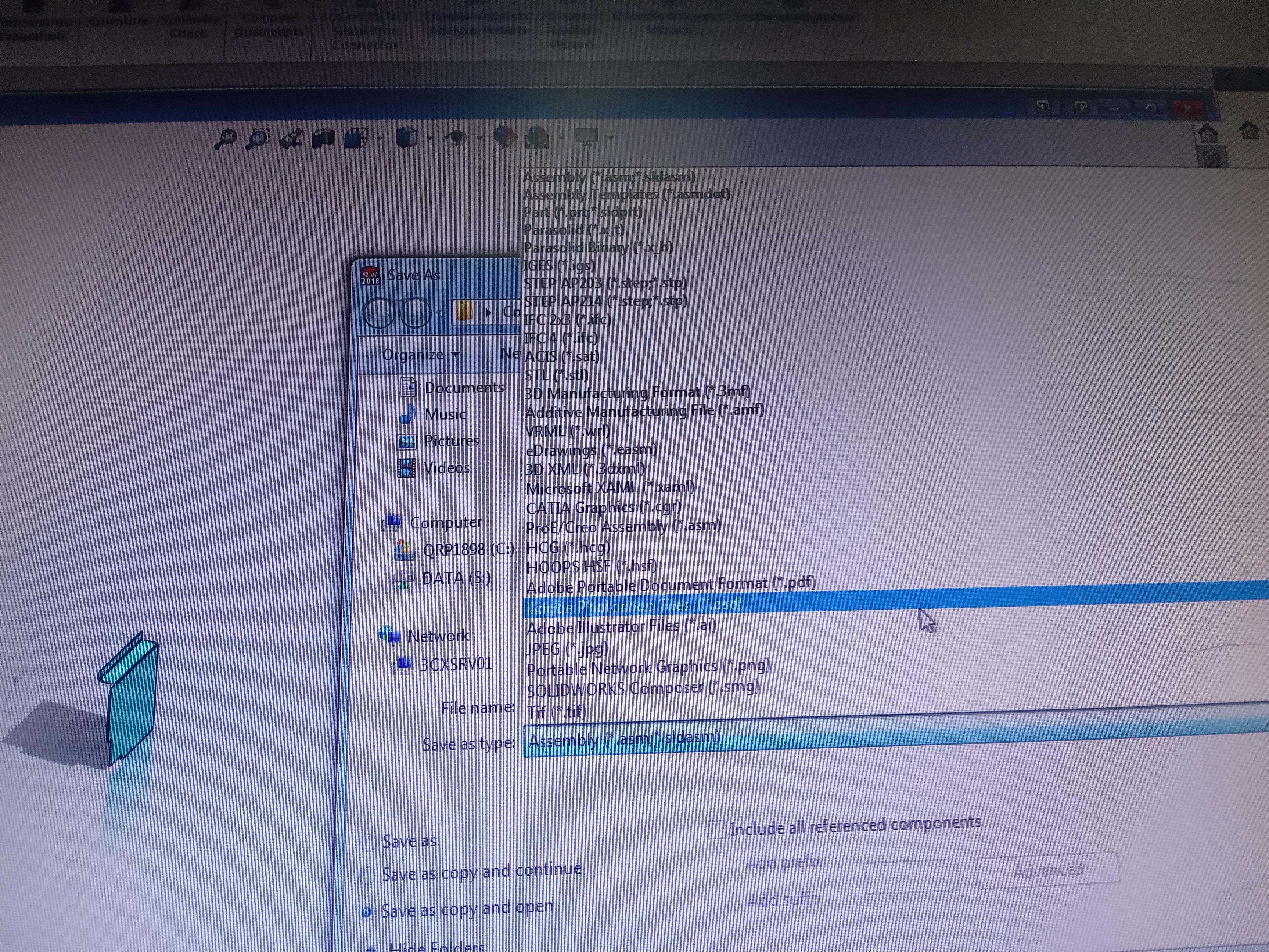

I'm using solidworks I've decompressed it and managed to open it via solidworks and I can see the assembly. I now need to save every component as a dxf file

There's no option to save bodies or save as dxf file I've managed to open it
From the assembly, open each part individually (select them i.e. via the FeatureManager Design tree), then click 'Save as' and select Dxf (*.dxf) from the 'Save as' pull-down menu, I presume?
Yes, this is the method, but first, part after part have to make an M1:1 drawing about the necessary cutting plan (without scaling of course) and these dwg save as dxf.
Tried the approach you suggested it doesn't give the dxf option or I missed a step? I opened it individually then tried to 'save as' but there's no dxf option
Laser cutting is going to require a 2D DXF. You have a bunch of 3D solid parts.
You have a lot of parts. It’s going to take a lot of work. There is no other method. I strongly suggest you get with the laser cutter programmer and discuss his needs. You don’t want to do this twice. Just any 2D drawing view of the 3D parts won’t work. It must be specific to the task.

To save a drawing as a "dxf" file, you can only save the drawing itself and not the entire part. If the part is bent, you will need to create a flat sheet first, then draw it and save it as a "dxf" file. That's all there is to it.
you could simply isolate each part and save as a display state, when doing the drawings, choose the appropriate display state and make your drawing, however if the parts are folded at all you will have to reverse engineer the part to get the flat pattern.
