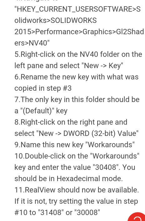

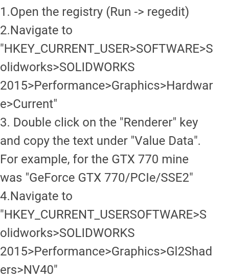

If your laptop has a built in GPU rather then a distinct GPU, you will have to create a registry entry for it otherwise Solidworks cannot detect the GPU as being present.
https://grabcad.com/danny.bichard.design-1 put up a tutorial previously

It's essentially the same problem for most of the last few releases of Solidworks afaik.
Hopefully it will work for you. I rarely use solidworks on a laptop and generally only switch to realview on my desktop.

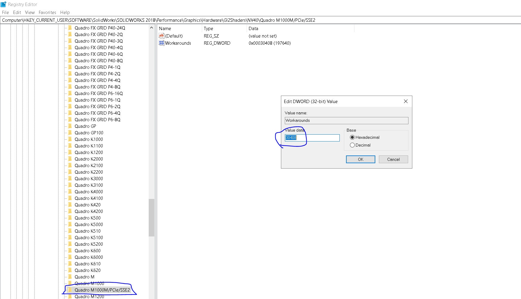

I tried everything on youtube, but my M1000M card cannot activate
