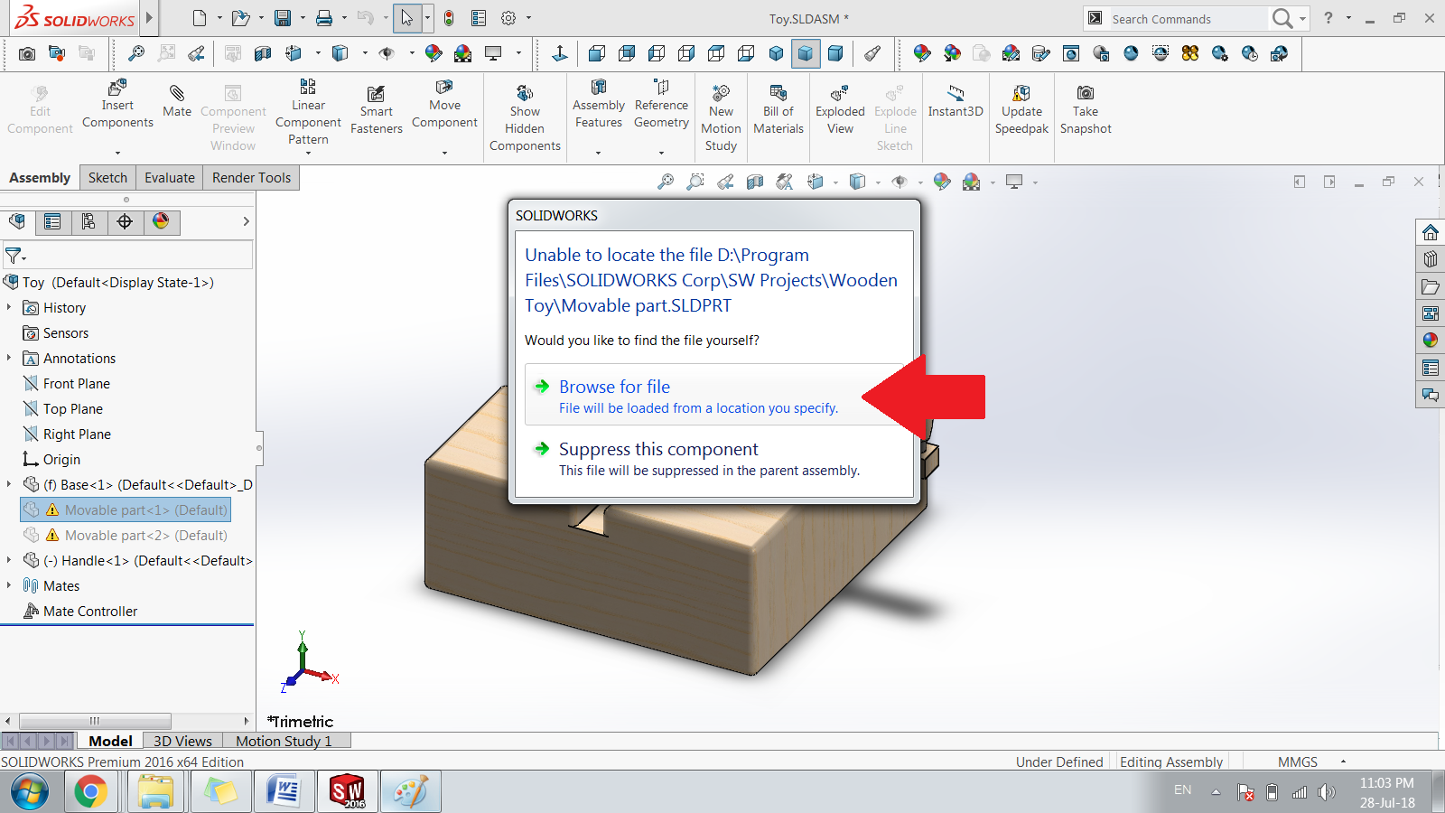

I open the final Assembly file on my computer with Solidworks 2018 but It fail. I can not understand why. Please help me. Thank you .
Please check my picture on Attachments
That's because you haven't downloaded the "part" files, or because SolidWorks cannot locate them.
Probably the second, so you'll have to browse for each one of them again.

It gives such error when it can't find the required parts whatever the reason was.

Browsing for the file will be much faster/easier

Right click the suppressed files, then choose "Open Part"
Select "Browse for file"
Note that the file must be in the location he mentioned, here it must be in:
D:\Program Files\SOLIDWORKS Corp\SW Projects\Wooden Toy
The upcoming picture shows the problem...
Although the 2 locations are extremely near, the software still needs the location the assembly you downloaded was "programmed" to look at
I think that you separated some part files from the original folder they were downloaded in
Now you know both the file's location (you can find it more easily by searching its name on your computer) and the expected location, just move it from here to there ...
Done !!!

Do these steps, and everything will be fine:
Try that with one file. If it worked (it should work if you did everything right), then do it with the rest of the files.

Yahya T Khedr . I got it
Thank you for your help. I solved successfully
