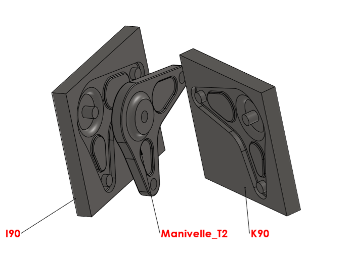

Hello i have a core ( I90) and cavity (K90) already created by another software , i want to extract the part ( Manivelle T2 ) from it
How can i do that on solidworks ?

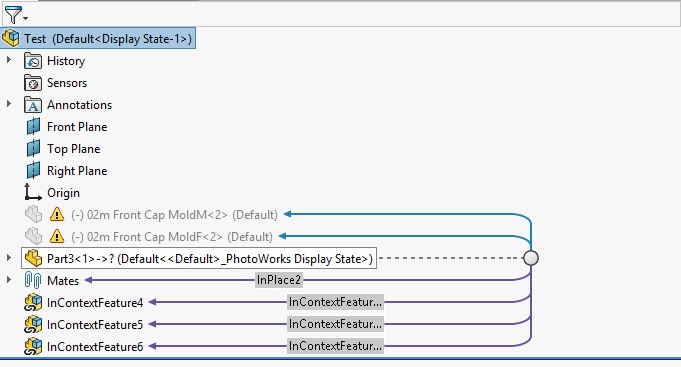

1.Create an assembly with both mold halves properly aligned.
2.Define in the assembly a new in context part, that covers all mold volumes, aligning conveniently the main planes to the mold halves contact surface.
3.edit new part in context, adding a cavity feature (Insert/Feature/Cavity) with one of the mold halves
4.keep editing the new part, this time adding a cavity for the other mold half
5.save the resulting part

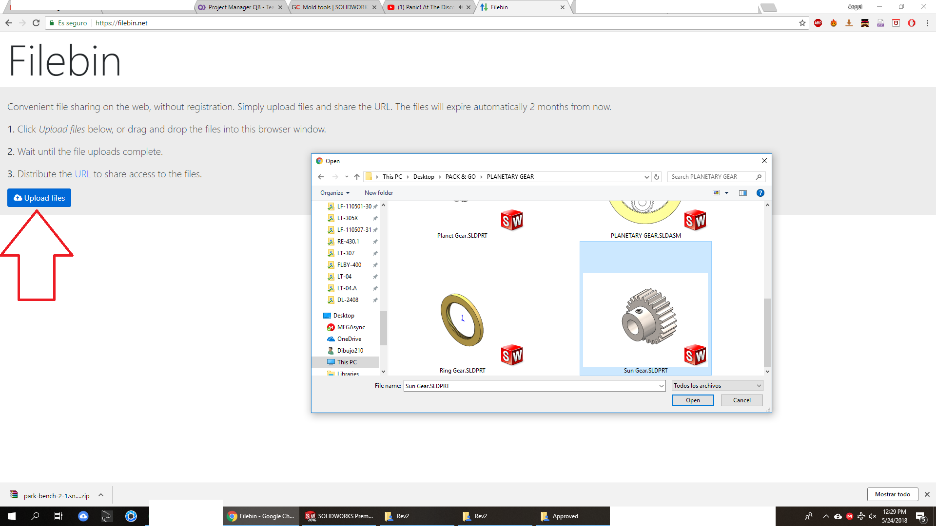

Angel, I'm afraid there's no way to share files in this forum. I found the possibility of sharing images only.
https://grabcad.com/teruteru-1
In Fact is not possible share files, but for now we can try this:
and share the links to improve the way we help each other
Ok then, here are the files from my example:
https://filebin.net/ytxfxu4frgvm2and

Your models are made with Siemens parasolid CAD. If you want to help from solidworkers with older versions of SolidWorks- save you files as .step
So, in your assembly circular references. You want to create molds from part which is created by molds...

I want to know what is the method to export part from core and cavity ?
if you can do it or me it's ok
the part's are from a competion , i am not the designer
