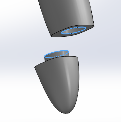

I can't say anything clear without seeing the track.

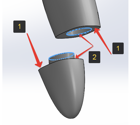

match the zones 1 and then match the circles 2 to the center command.
Do you want to match the external profiles?

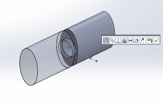

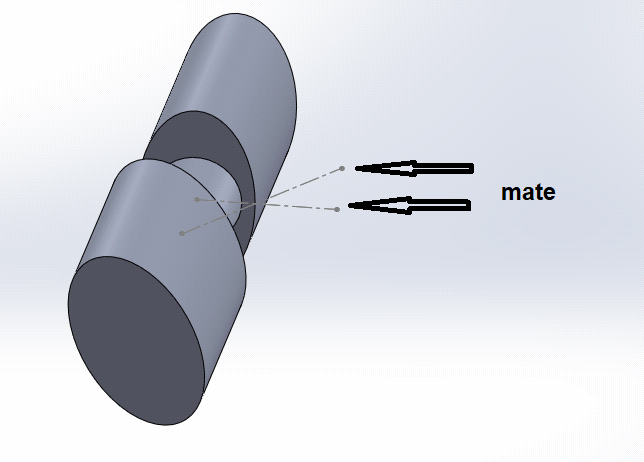

An easy way is to create a sketch with a center line with the same directions in both parts. Then you can mate the center lines
After that, occult the centerlines.
similar to shew cavalcante above, I use planes to clock the profiles, usually with a parallel mate
Create planes on each part file, then mate the planes.
