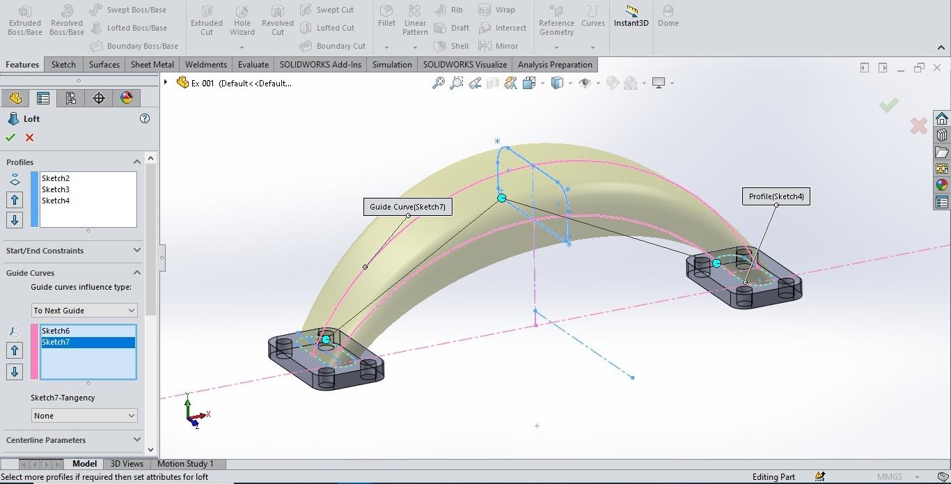

Hi, I need help with this arc in the drawing. I'm using Solidworks and I can't get it to extrude with varying thickness. Thank you!!

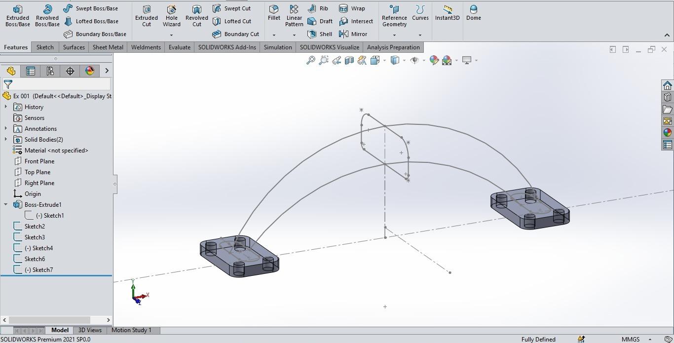

It's not complicated. The procedure is as follows: 1) I create a sketch of a groove 12 mm long, 2) I create a reference surface perpendicular to the original one and in alignment with the axis of symmetry of the part, 3) I draw a groove 20 mm wide on this reference surface, 4) then I create a curve on the surface perpendicular to the two previous planes indicating the shape of the part, 5) I use the command "add profile connection" (SW2018), where I mark two sketches and a guiding curve. This will create a part with variable thickness. The rest is obvious. I can share the model.

Use Loft Command with Guide Curves.
See the attached Screenshots for your reference.

thanks for the help, I got it now. earlier I was trying with a swept boss instead of the loft boss.

I have come up with a solution in Solidworks 2014:
https://grabcad.com/library/request-handle-1
that comes pretty close to the template. You need to construct extra guide curves to get the linear transition seen end-on.
Loft is not magical fix for everything , don't use it if you don't have to
This model is just couple of extruded arcs and fillet
