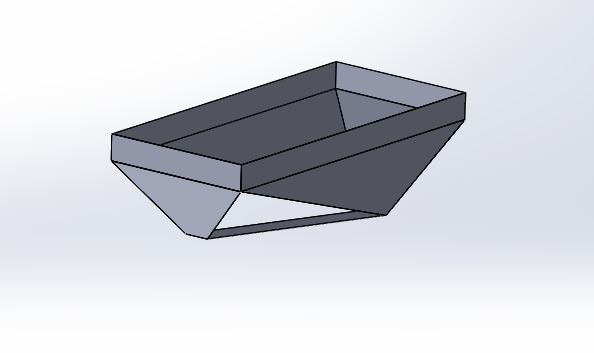

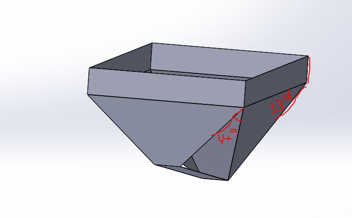

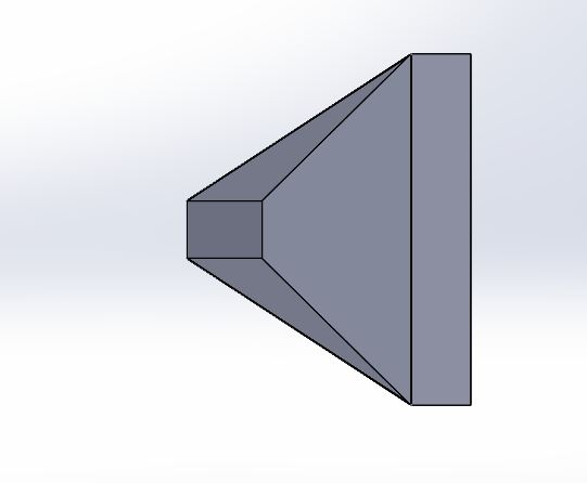

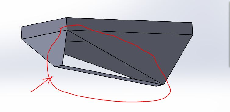

i am doing a design of a hopper , but have a problem , the empty part can`t find a feature to charge it and make it continuous with the other part above cause the sketch is between two planes . what is the solution for this advanced feature ?

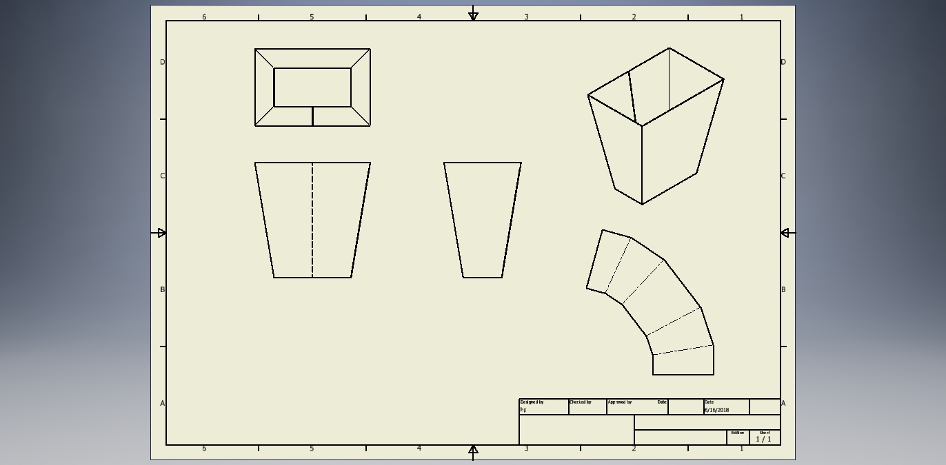

sometime you can creat solid model but later convert to sheet melal. place give a file I look

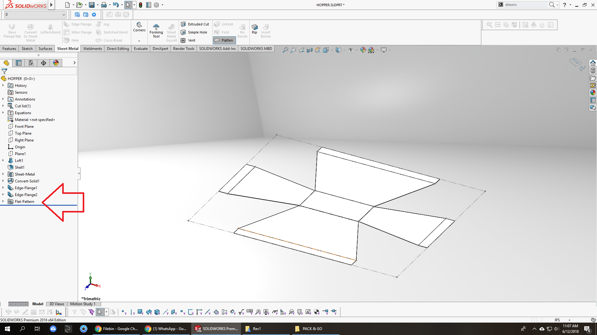

forget what happened to your file, I made a new one, just change the dimensions to what you occupy, look how I built it, so for the next you already know how to do it, I hope it will be useful.
download your file here: https://filebin.net/gdgjirf7mvne4hom
you must to cutting the flatt part in 3 parts after save as dxf , because its impossible bending in this dimensions in 1 parts !
See me hoot in me project. All its divided in multiparts.
if u want to make such part in sheet metal, make it in 4 different part and weld it.
for liquid handling do the leak proof welding if u r trying in one piece it is not possible to bend 1.6mm sheet is sufficient
