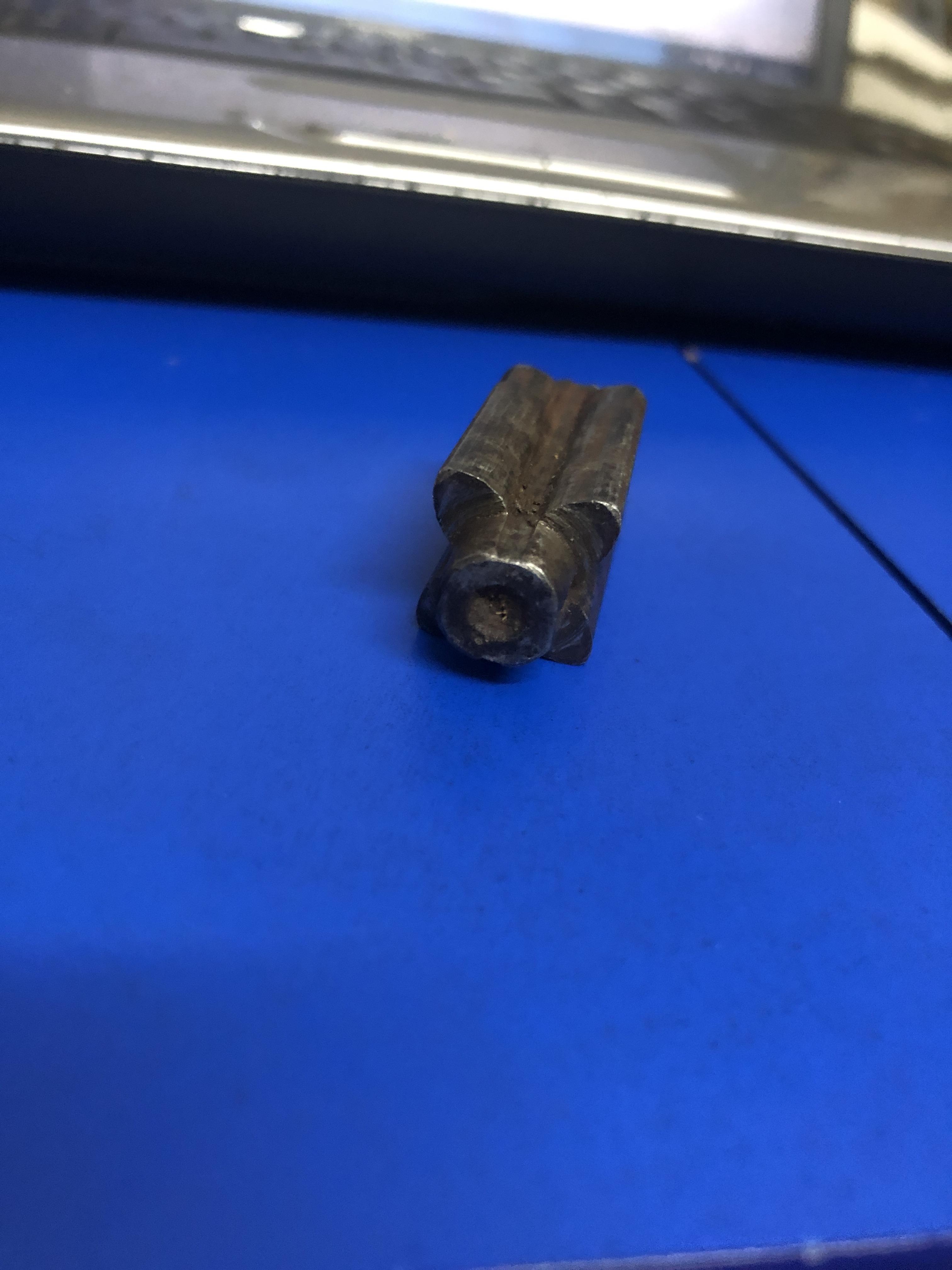

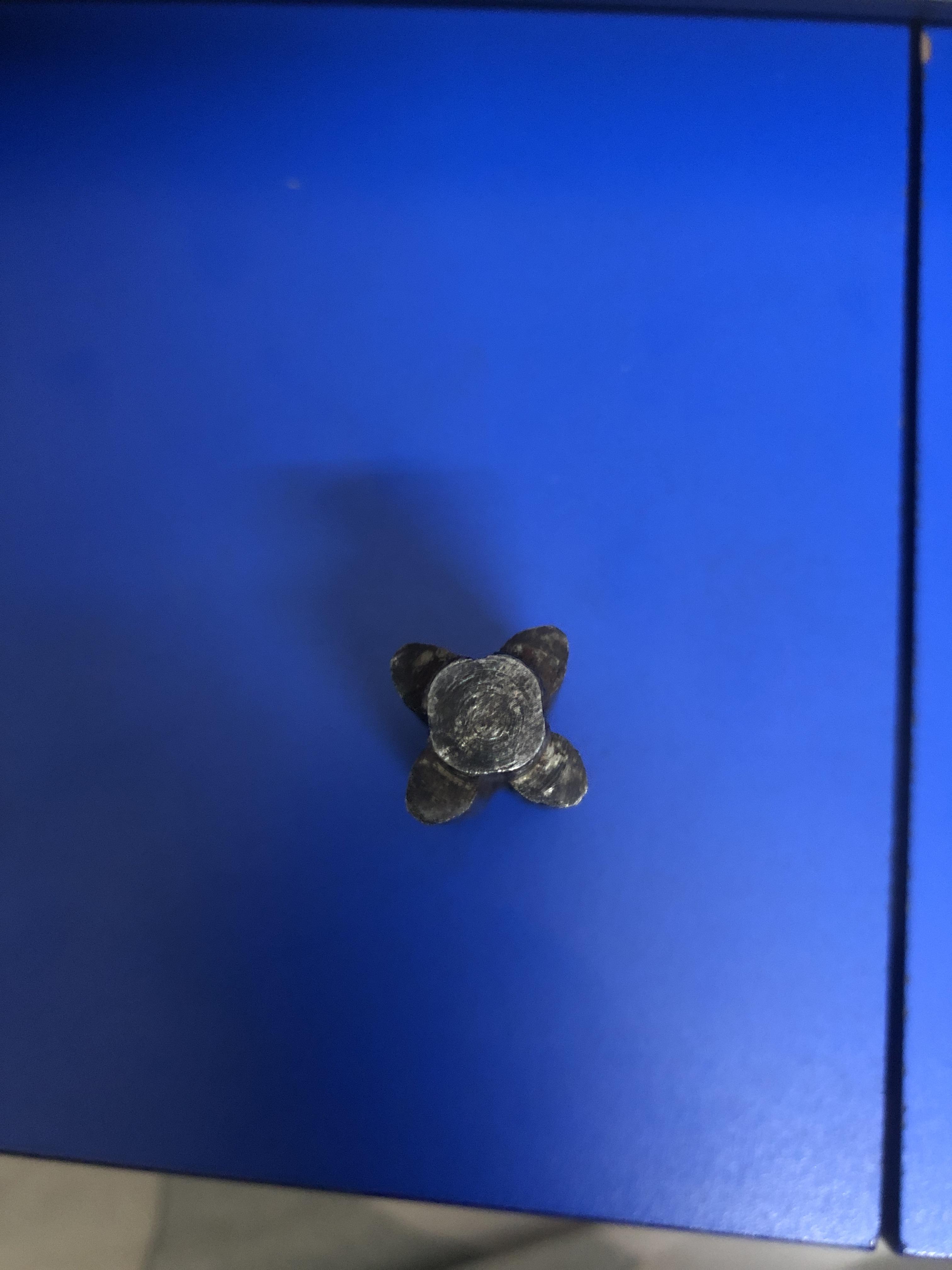

Less than 17 no. Of teeth count is very common!
one
example of such gear reduction can be seen in manual chain pulley blocks.
5teeth pinion / 18 teeth side gear ,3 mod
4teeth pinion / 19 teeth bull gear, 3 mod
however, these have special profiles by manipulating the Outer Diameters and depth of cuts, while keeping the pressure angle to be 20degrees.
If any one can help designing such profiles then it will be a great help.
specially in 3d modeling softwares.
photograph of 4 teeth 3 mod pinion straight from the triple spur gear chain block
