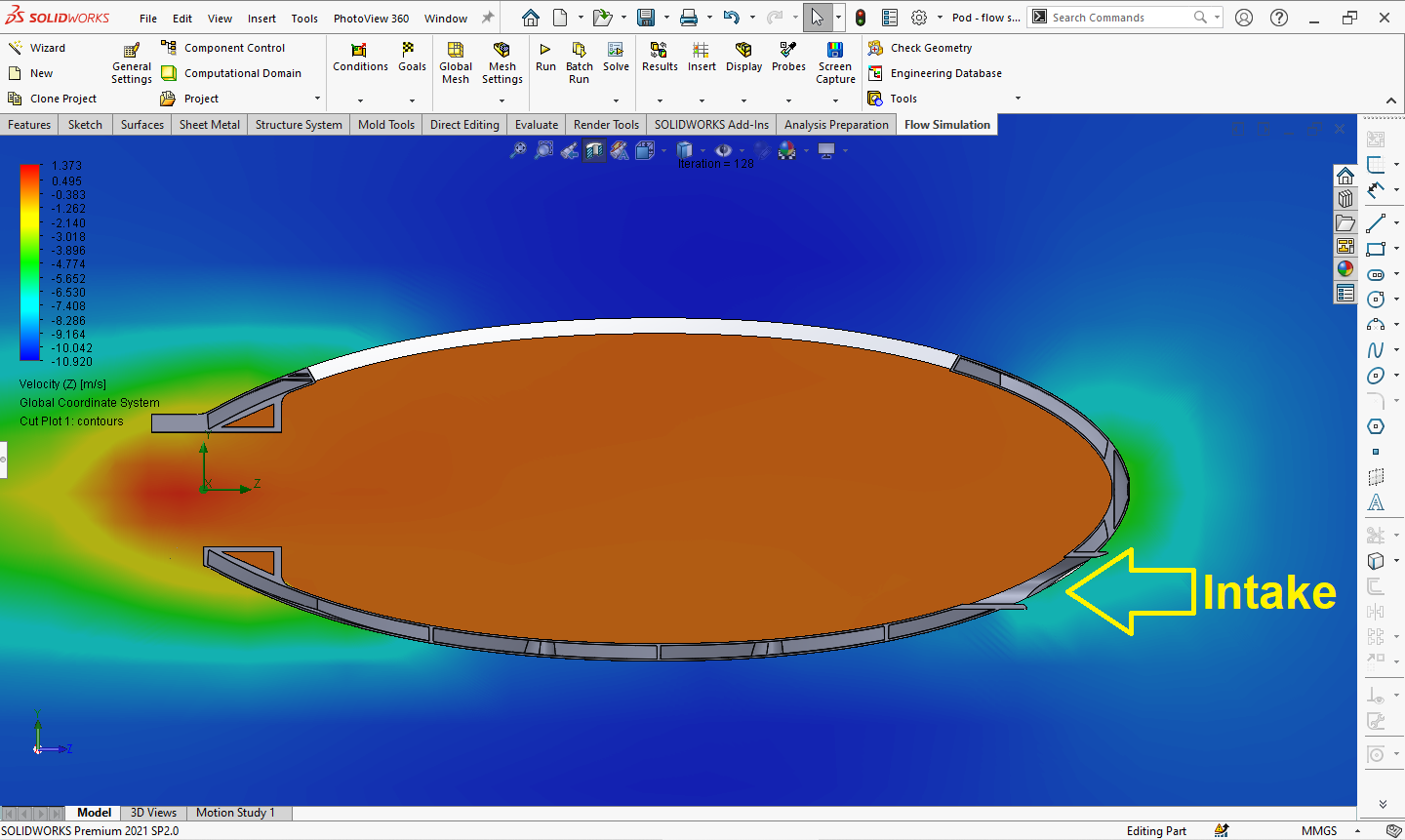

Hello there!
I'm designing a sensor pod for a mapping application, it is going to be mounted under a helicopter.1
I created an intake to let the air get into the pod and cool down the electronics, but in the simulation, Solidworks acts like there is no intake and doesn't apply the airflow inside of the pod through the duct.
what is wrong with my simulation?
It would help if you show images of the "general settings" of your simulation. Perhaps you have only defined an "external flow" study.
