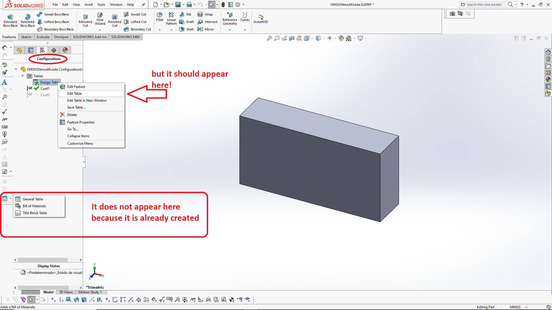

The design table is embedded in the SLDPRT. So when you save it under another name, you should have an embedded layout table available in that new file!
I did the test of generating a file with design table (although I don't have Excel) and saving it with another name and it works fine.
Of course, the "design table" option does not appear because you already have one created...

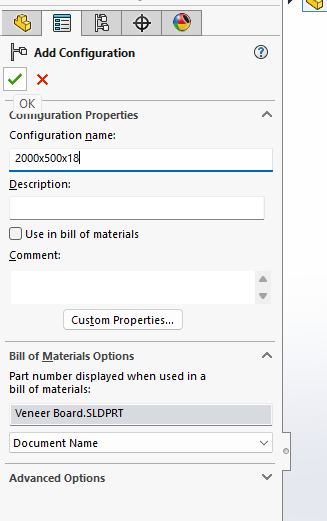

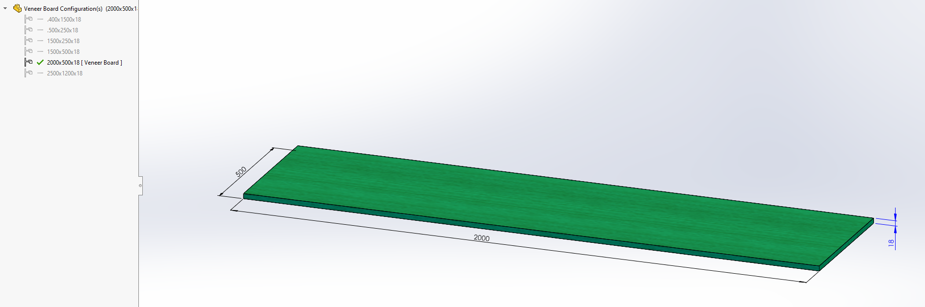

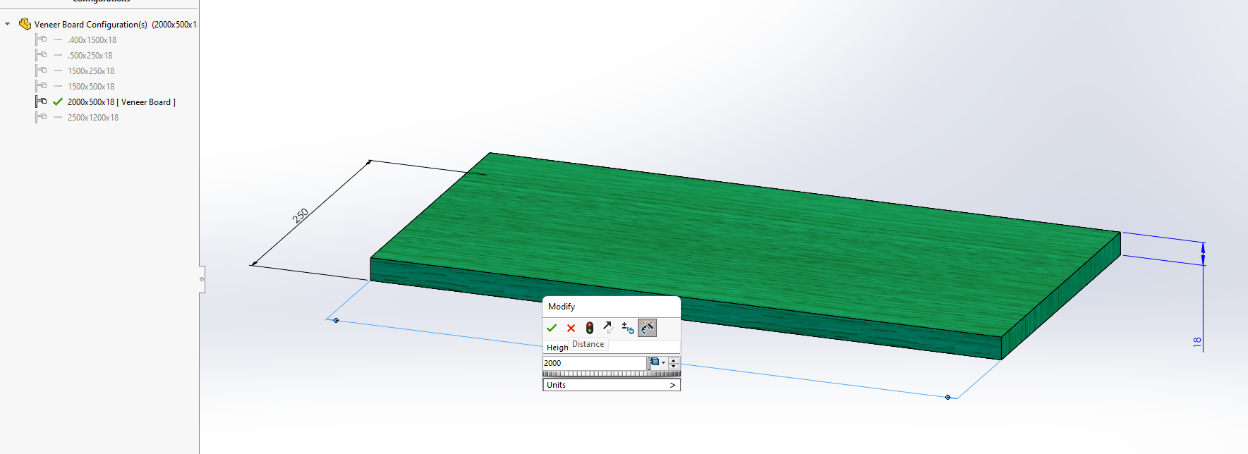

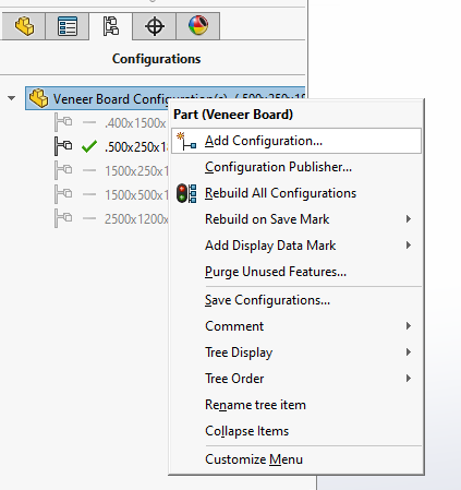

I think Robert, you are trying to make something too much complicated. Explain to me why you need to use Design Table, as the feature, instead of creating a new configuration straight away without Design Table.
How to add new configuration in any part. To activate „New Configuration” you have to use the right button of the mouse.
