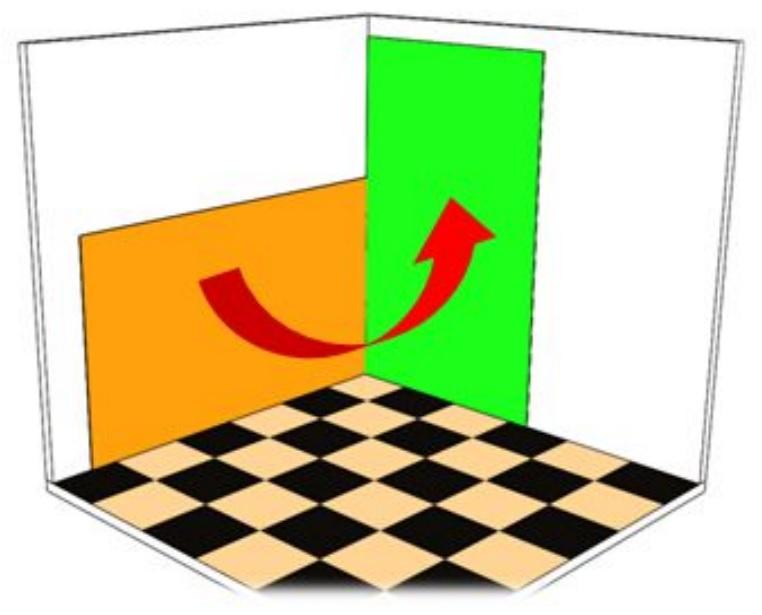

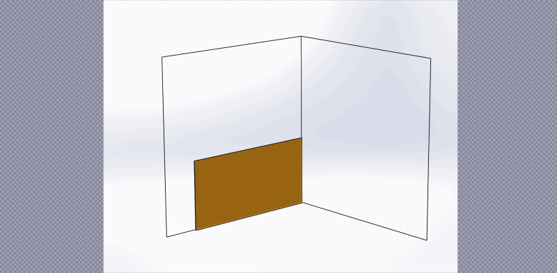

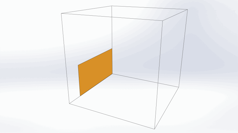

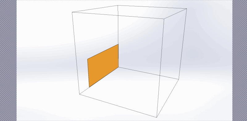

Problem statement:
Let it be a rectangle with one side green (front) and another side orange (back). Its initial position leaves the orange face visible, with its long edges in a horizontal position. Its final position leaves the green face visible, with its long edges in a vertical position. It is requested to design a mechanism capable of moving it between both positions.
Note "take with a grain of salt":
Just to help with visualization (as long as it does not involve adding restrictions that do not appear in the statement) you can think of this rectangle as the exotic gate of a garage, but what is drawn as "floor and walls" are not really part of the statement and It does not matter if they interfere with the movement of the rectangle.

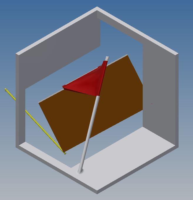

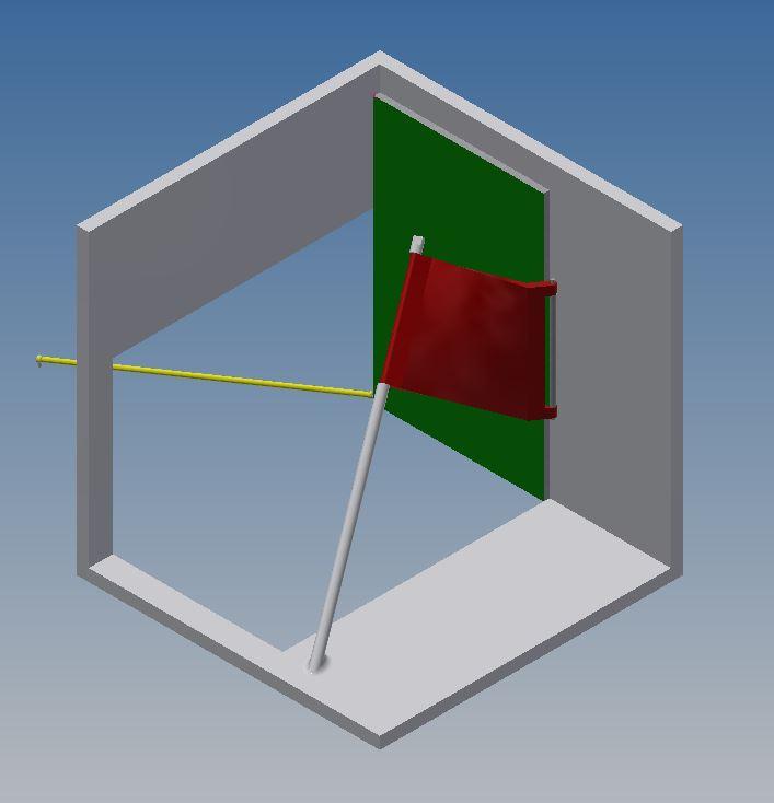

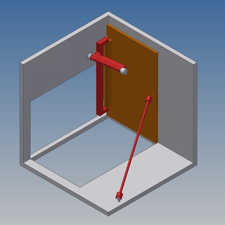

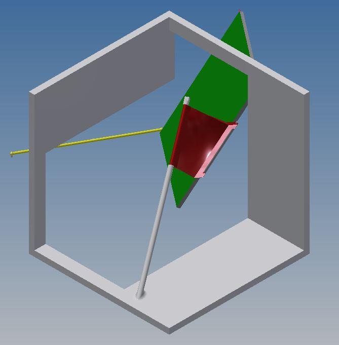

My first thought was there could a single hinge in space around which the door could be pivoted between the two locations. This turned out to be impossible. However a single hinge could be used for one edge of the door then a ball linkage used to guide the opposite side of the door.

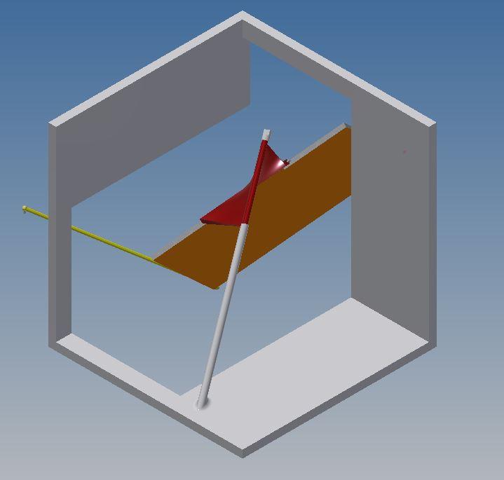

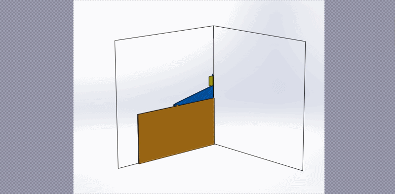

This was carefully laid out using Inventor. Consists of a pivoting link on the upper edge of the door connected to another pivot located on the wall above the door. Then a link with ball joints at each end from the bottom of the door to a point on the floor some distance away.
The door movement interferes with the floor. This of course was a non-issue according to the criteria given but I decided to cut away the floor for clarity.
Now the problem with this arrangement is the same face is presented on both positions, which violates the criteria. This was not realized until after completion. However a similar mechanism could be generated to accomplish the originally stated goals. Time constraints prevent me from continuing so I present my incorrect results for the sake of generating interest.
Excellent Bob!
It is much more detailed than is necessary for this exercise.
It's very good that you noticed the issue of the final position, which does not respect the problem statement. Precisely "the interpretation of the problem statement" and the licenses that one can take (or sometimes, the restrictions that are added unnecessarily) are the "lesson to be learned" in this simple exercise.
Kind regards!

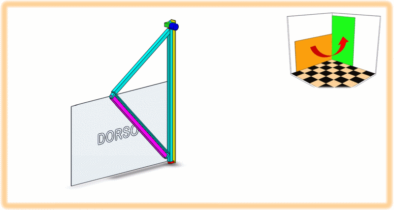

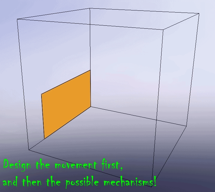

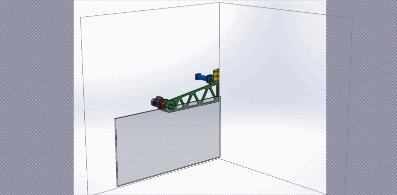

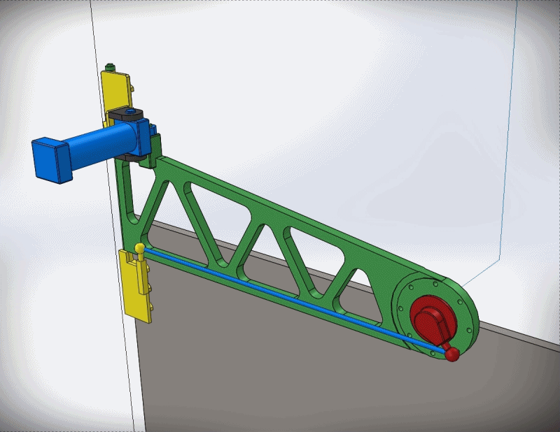

We present to you (as a work team) a progress that respects the recommendation that Marcelo always makes to us:
First you have to design a movement (among many alternatives) and then, design possible mechanisms (also among many) to carry out said movement (at least, approximately)!
I love that they are methodically applying design practices!
As long as they start by "solving the mechanism" and accept the movement that it provides (the opposite of what is recommended), they will fall, like many, into designs that are "more of the same", incapable of even exploring something innovative.
Well done!

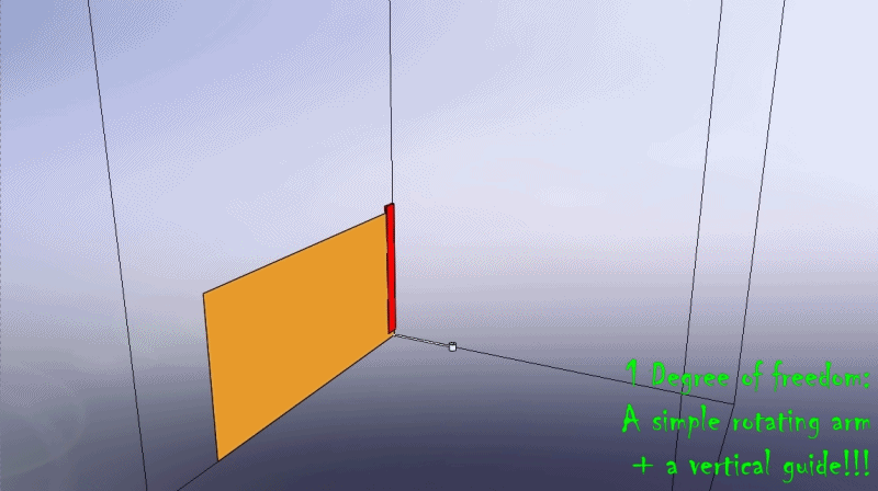

It is surprising that it can be solved with a single degree of freedom and, therefore, a single motor!
A simple rotating arm + a vertical guide!!!
PS: Of course, there are details to discuss such as small "elastic aids" to get out of deadlocks and avoid ambiguities.
Very well thought!

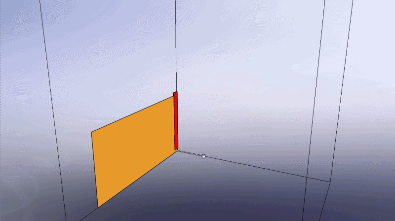

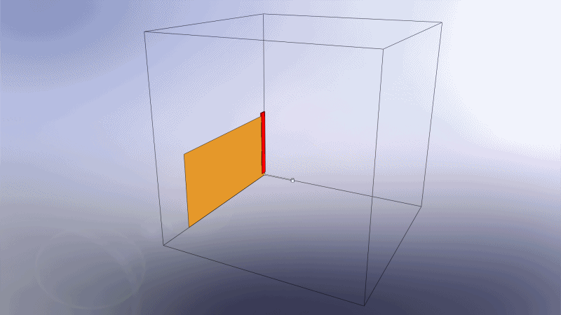

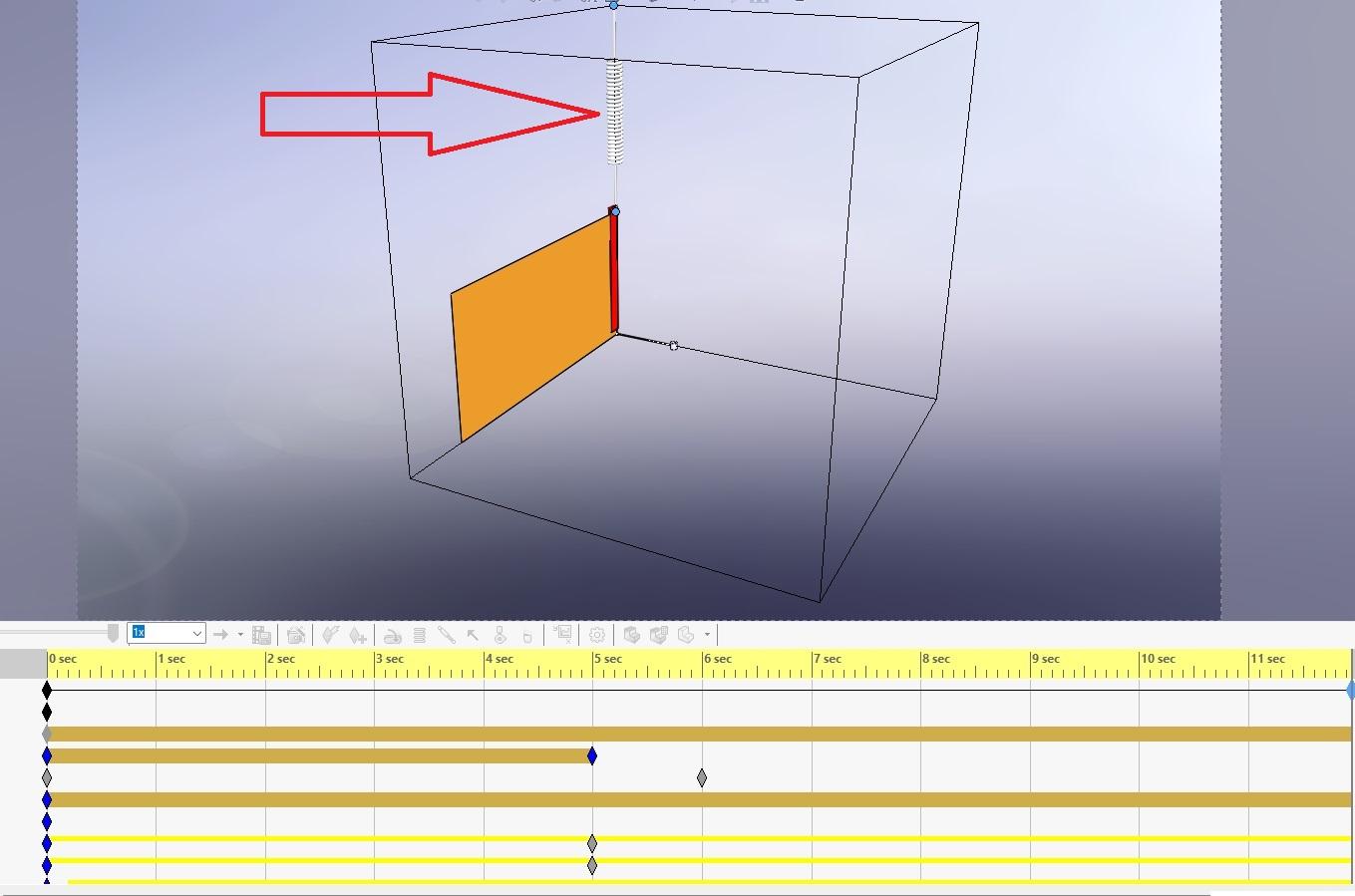

I notice a slight change in strategy. Yesterday a triangular rotating frame was observed to support the movement. Now they have simply controlled 3 strategic points of the rectangle.
It's true! We changed our mind after carefully observing the movement and noticing that:
1) a vertex of the gate simply went down and up through a straight line...
2) another vertex described a semicircle...
3) the plane of the rectangle always contained the line along which the first point moved...
The happiness was short-lived when we discovered that the final position of the rectangle was a kind of dead point for "this mechanism" and that it caused the ambiguity of the movement of the rectangle when it wanted to return (reverse the direction of rotation of the motor).
We corroborated this using SolidWorks MOTION, which by reversing the direction of rotation eventually moved the rectangle in the undesired direction:
The solution (virtual, in Motion) consisted of adding a spring that "helps to get out of the dead center in the correct direction" which, in a real mechanism, could be an elastic support that fulfills this function (not along the entire length of the spring). movement but only during final support).
Motion simulation with motor and spring:

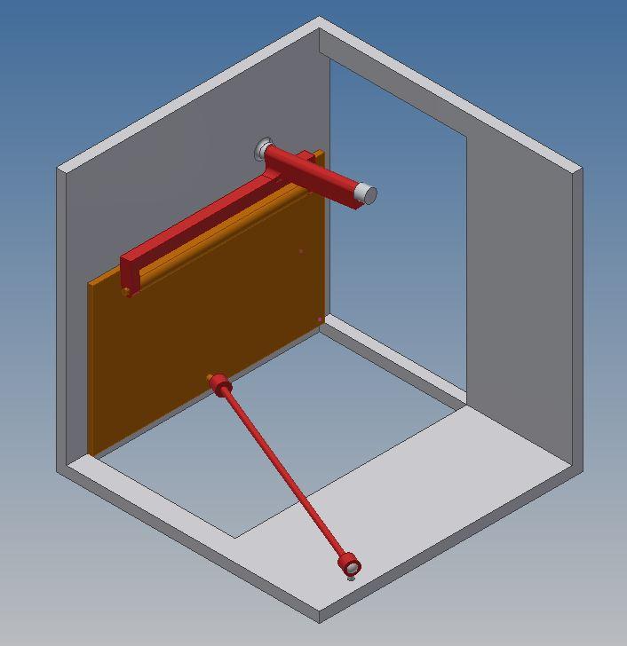

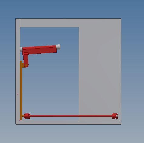

Reworked so the correct sides are presented.

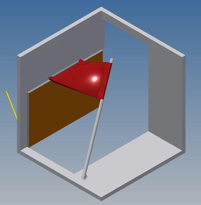

Similar method as before. A pivot along one edge and a ball link for the opposite edge. There are obvious issues if this were destined for the real world but it achieves the desired motion with no ambiguities.
Grabcad would not let me post the video on this post but It can be found here:
Excellent Bob!

Something very important that has been left pending in this proposal (which resulted from 1 degree of freedom) is to indicate the place and form of its motorization/drive to check if it implies a uniform advance or if it has dead spots or other inconveniences for mobility.
We must remember very classic cases such as the connecting rod-crank mechanism used in internal combustion engines. The basic "mechanism", understood as the set of links, is unique and results from 1 degree of freedom, but its behavior changes greatly depending on the place and way in which it is motorized/actuated. For example, if we drive it with a rotary motor on the crank (as happens in air compressors) the mechanism has a fluid movement even when passing through its dead points. But if we operate it from the free end of the connecting rod (as happens in internal combustion engines, through the explosion of the fuel that drives the piston) the mechanism "locks" in both dead points (upper and lower) and even It can come out of them in an ambiguous way (turning in one direction or another). For this reason, internal combustion engines require "a mass that provides momentum in a certain direction of rotation" to be able to pass through dead spots without problems.
If driven by a simple motor at the main pivot point (the stationary end), mine has no dead spots and has a continuous fluid movement. The relationship of the rotation angle to the relative position of the door is almost linear. Therefore, the rotational force required would remain nearly constant.
Because the ball link stationary end had an infinite number of solutions along a single plane it was originally tried adjacent to the main pivot. This resulted in dead spots and very acute included angles. (Something that would generated unnecessary high forces in the real world.) Moving it one time to a random position opposite the initial door position as shown resulted in good motion with no extreme included angles.
The geometric construction (descriptive geometry) required to develop this mechanism was advanced but quite easy with the 3d CAD system. I shudder to imaging doing it on the drawing board with a T-square.
The main criteria that drove me to this solution was that the only thing that really mattered was the starting and ending door positions. The intermediate paths were inconsequential. Trying to predetermine an intermediate path, in my mind, only limited the possibilities.
