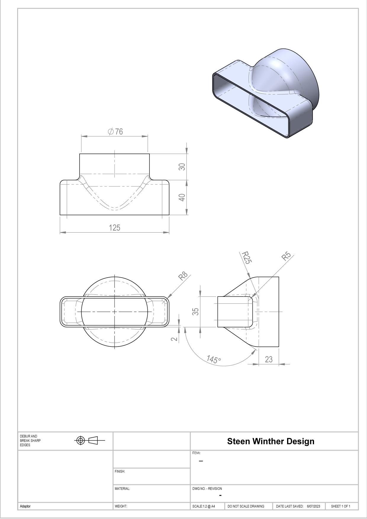

Haven't had a challenge part for awhile. Here's a simple one, although not much of a challenge for the experienced users who know how to model thin-walled parts.
(Some dimensions are missing, so just add whatever you need)

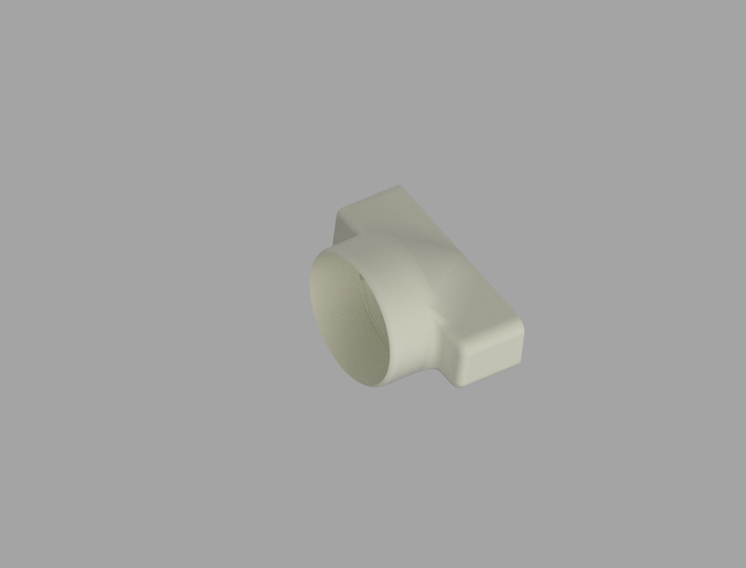

Nice little challenge. If you know the features it´s an easy one. Took me 5 min. in Inventor:
Nice little model. The only missing dimension is the length of the straight ø80 section. It is an easy model if you choose a simple approach, but I suspect that it could prove troublesome if you try to do too much in one step...?
I have a version but I think I am missing something. could be missing dimensions or I am overseeing something. The fillets do not match the Isometric view in the drawing.
It looks to me that the arc that is R25 on the drawing is drawn differently?
Interesting - I don't believe that I used a seldom-used tool. I did a revolve, an extrude, a fillet and a shell?
This was my instinctive Solidworks method as well. :D

It’s the order of the fillets. The 8mm fillet should be first. The large fillets second. The 5mm fillet must be done last.

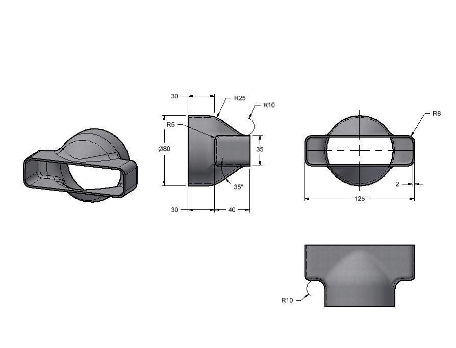

The fillet at the juncture of the square and round sections is not detailed on the original. I set it to 10mm and it looks about right.
Yes, sir. You are correct - I misssed that stupid fillet that makes all the other fillets meet in a nasty mess.

More interesting than the model for this challenge is the variety of drawings everyone created for it. I'll add my own.
