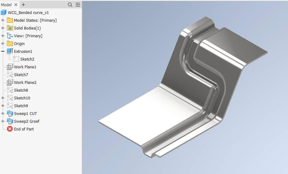

Do all operations only on the top face of a big extrusion. Then shell it.
Thanks Bob, it appears that FreeCad has something similar so this would work perfect. My final drawing was done using a pad, an additive pipe, and then a subtractive pipe, but using your method lets the computer do the work -- nice!!

Sorry if I am late to the party. I never knew this group existed. I used to take part in the Low Feature Challenge regularly. Here is my version. SW. 3 features. Same technique as Bob. Extrude, cut and shell.

Is there a faster way to make this? I used a lot of sketches and two sweeps (one to cut out a path for the other sweep to fill in). I have approx 3/4 year of experience with Inventor and would like to learn more.
