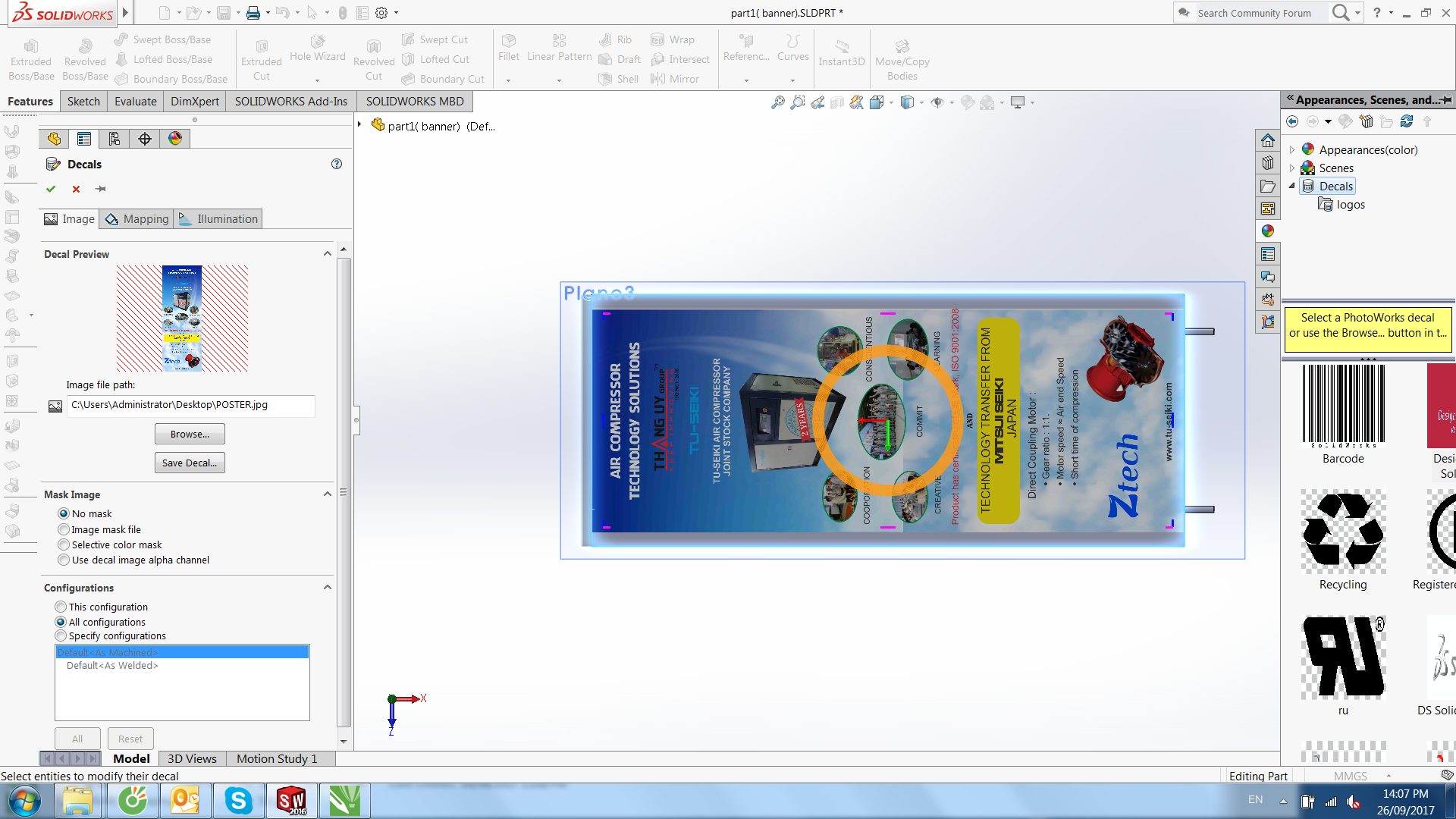

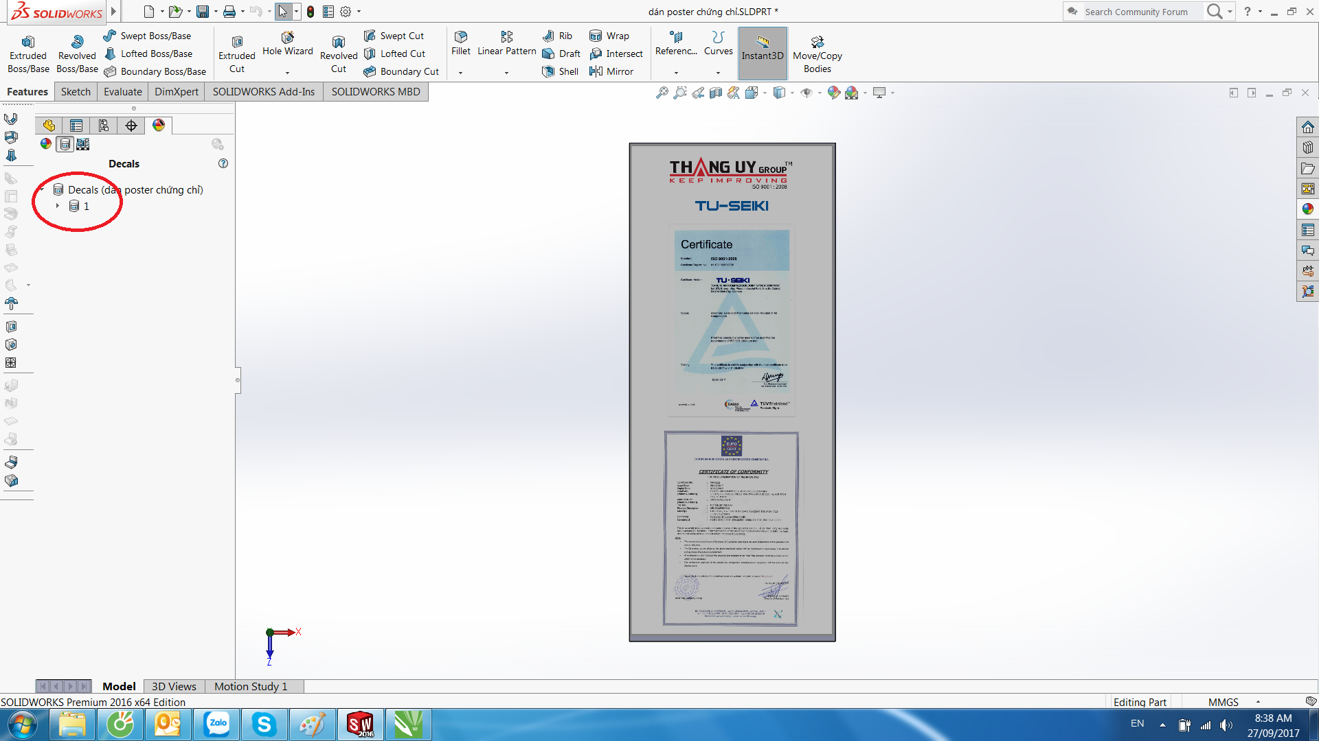

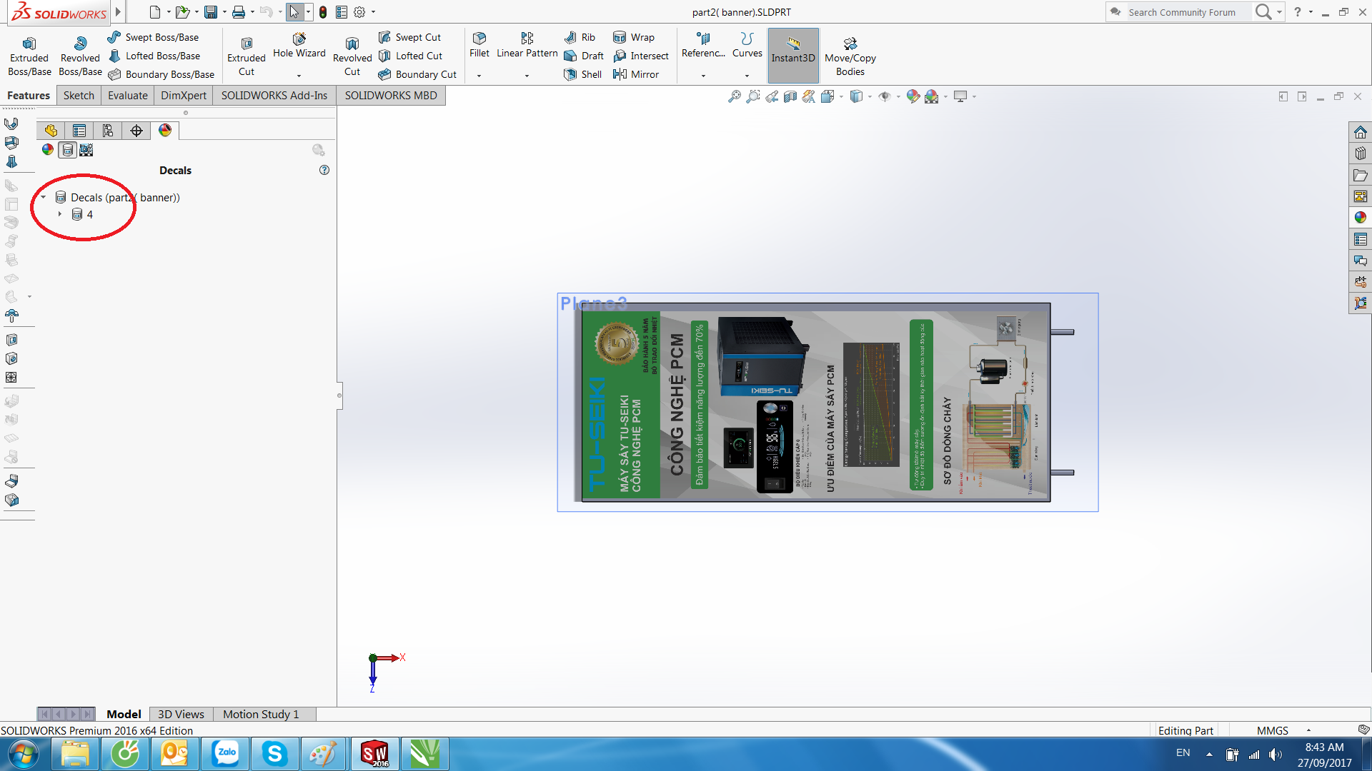

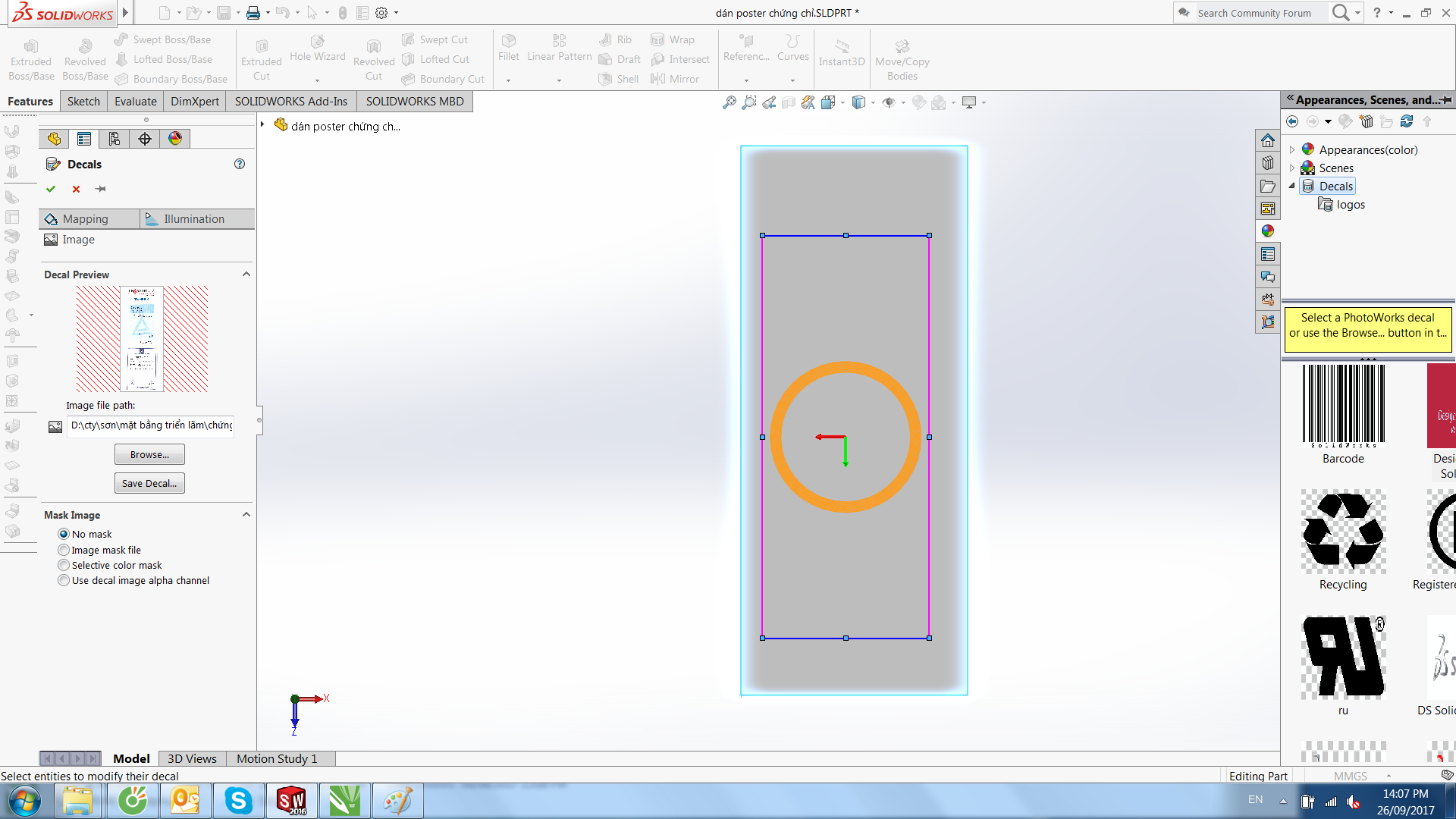

Adding decal in solidworks Sơn Trịnh 26 Sep, 2017 07:09 AM I'm trying to add some decal in solidworks. Some picture when i add it's appear, but some can't. Any one know what is the different? 5.png 6.png 2 Answers Sơn Trịnh Answered on 27 Sep, 2017 01:44 AM Unbelievable!! When i change the name of picture to number, it's show up in decal... Can't understand this. Untitled2.png Untitled.png Richard Barber Answered on 27 Sep, 2017 10:01 AM did the original name contain vn characters? i've seen other software not able to handle filenames with international character sets.
