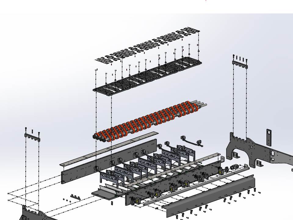

You are right, that most of my steps include more than one part. (This makes it easy to keep them in alignment when I adjust their positions.) And some parts are moved with 2 or more steps. With this assembly, I'm not sure it's worth the effort to explode one part at a time. I'll try to attach a picture tomorrow.
I did delete the exploded view and started over - twice today. The first re-do; I only typed in distances and use Apply, Done and OK for each step, but parts still jumped back when re-positioned. In the second re-do, I only dragged parts to position and re-position them, but again with they wouldn't stay put. My conclusion: it doesn't matter which way parts are exploded.

here's the assembly I'm working on. Almost 90% of explode steps have multiple parts.

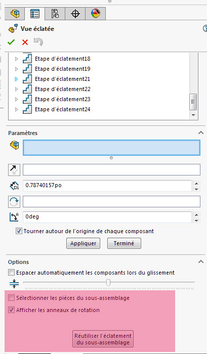

Solidworks allows the bursting of already exploded subassemblies that help you when using this feature. It is much easier to find and in addition it is usually a good thing to split the large assembly into subassemblies.
Use the features in the red rectangle.
Also, maybe you could use more than one exploded view.
