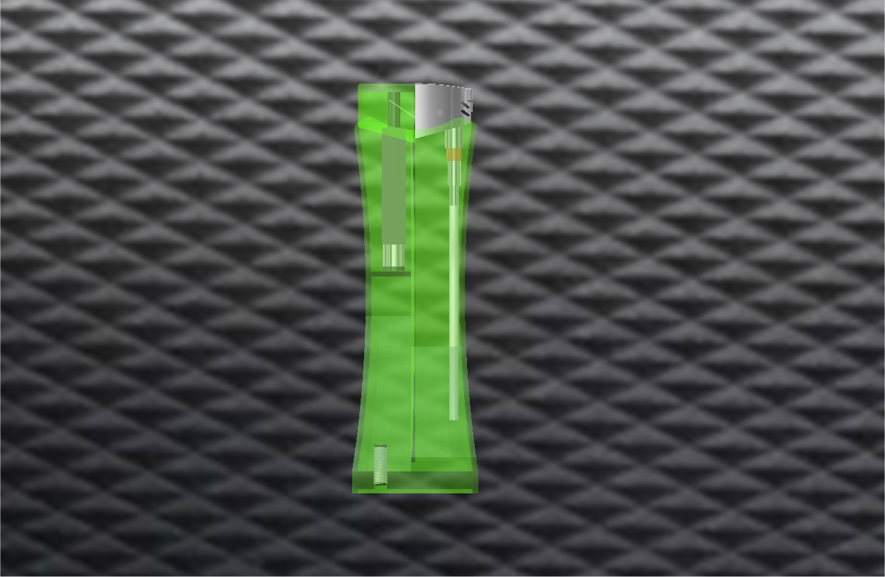

Can I add texture to my background in Solidworks? Kawaljeet Singh 30 Oct, 2018 07:53 AM I want to add a background similar to one in the image attached. Please guide me how to do this thevapingdragon_42002959_352559605288635_1146841294805762695_n.jpg 2 Answers Robert H. Answered on 30 Oct, 2018 12:29 PM System options > colors > select 'image file' under 'background appearance:' and choose the image you'd like to use. CadCloud Answered on 30 Oct, 2018 01:59 PM This using a background plate with a image decal diamond back.png Lighter.png
