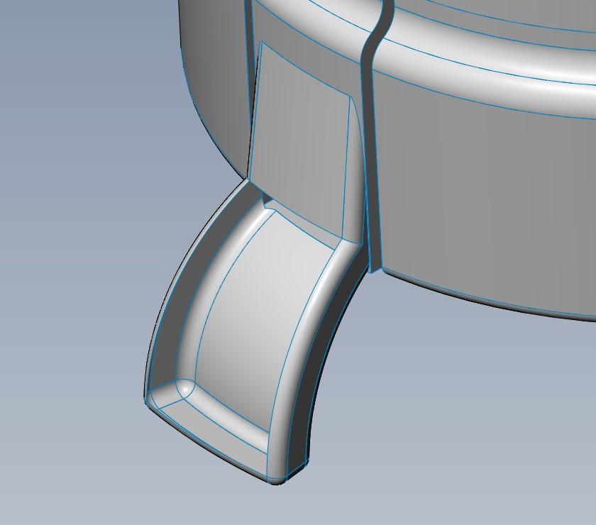

Can someone tell me how to import attached STP / STL file as a solid body object?
Using 2019 SWX, I've been unsuccessful getting a solidbody part file. Am getting surface only. Don't know how to make modifications to it. Files are attached here.
Accepted answer
Try this. There was a missing surface in the tab area, once that is constructed, it knits and forms a solid just fine.
