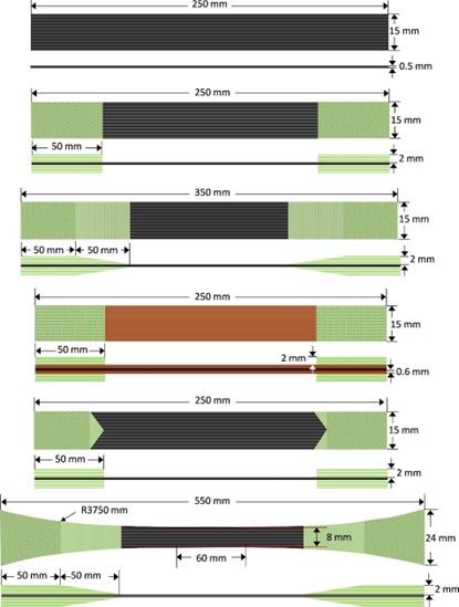

Can you draw 2 tensile test specimens for the testing of CFRP specimens which have tabs attached to them.
The overall length required is 250mm, the thickness is 0.6mm
