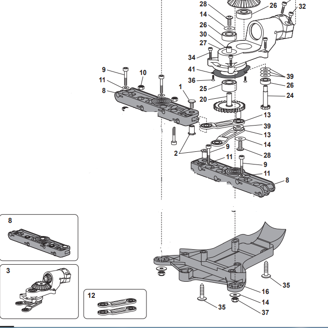

I am having a problem understanding how it is possible to transform continious to an alernative rotation using only 1 linking rod for each part.
The link rod (12) is connected to the eccentric from one side and to the edge of part (8) ,
Part 8 is alternatively rotating (in its center) in a limited angle
As described in the exploded view below.
