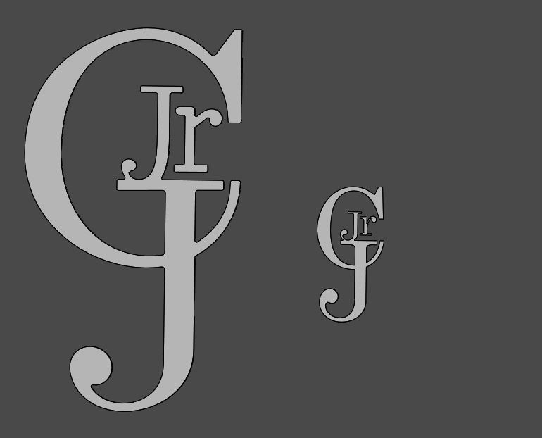

Here's my 15 minute try. You can play with and/or replace the splines in sketch1 to adjust to your liking, but this should be close and give you an idea how to manually construct a cad model from an image.
"artsy" stuff isn't my gig, so it might not be good enough for what you're trying to do.
-edit to replace cad files and images, I did a 2nd version with sketched text in 'century schoolbook' font, not sure if that's the right one, but it looks much sexier than my spline trace fakery.
Depending on the planned use, the original logo is of too low a resolution to be easily converted into a good vector file.
Recreating the model with fonts as Robert has is a great and easy option.
If you have a much larger, or higher dpi image to start with, it could be cleanly converted as well.
