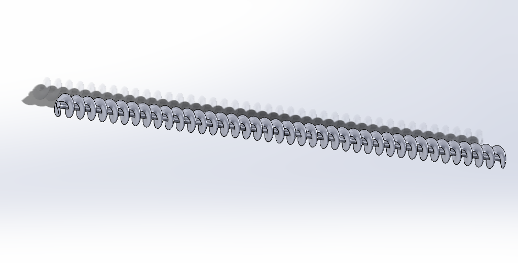

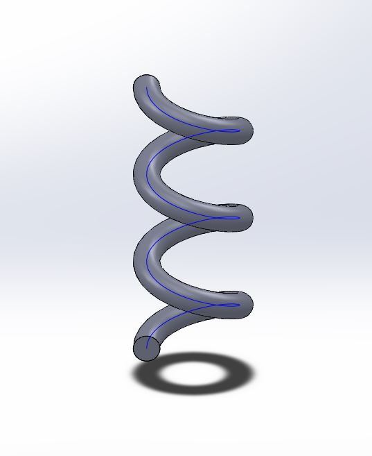

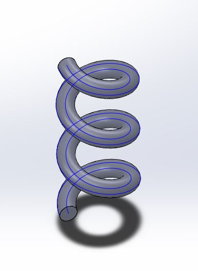

I tried to create fin (such straight cylinder ( pic 1)) on helix surface ( second pic )
but I could not find order to do that ( even curve pattern could not help )
can you please give me advise how can I create such fin on coil ?

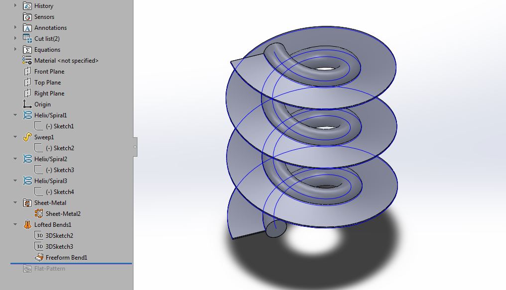

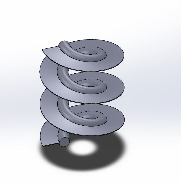

Here is a step by step for what i think you are asking.
1, Create a helix of the dimensions you require.
2, Sweep a circle profile along the helix.

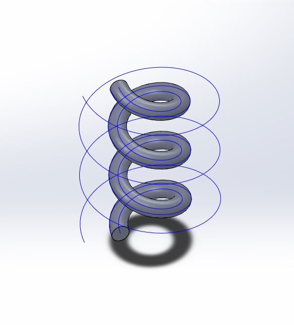

3, Create another helix along the outer edge of the sweep feature.
4, Create a large helix to represent the outer edge of the auger flight.

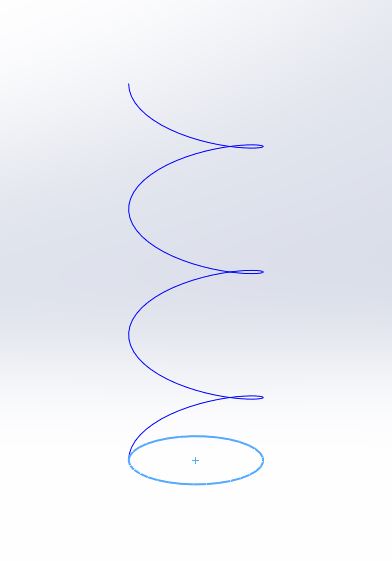

5, Convert the most recent two helices into 3D sketches in individual sketches for each.
6, Insert a lofted bend using the converted sketches.
Following on from your message, is this what you aim to achieve?
