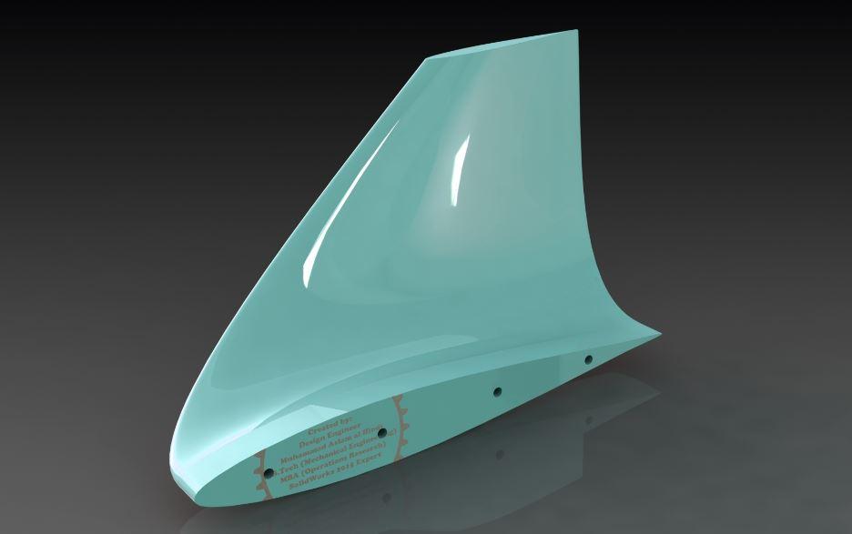

Creating a winglet using solid works?
I am fairly new to solid works and I need to create a winglet to eventually 3D print. I have attached a picture of an ideal model that I found. I have already sketched the aerofoil but I need some advice in creating the curve of the winglet and how I can make it a specific angle.
Thanks for the help in advance!

In addition to what Robert said about guide curves and lofting; you may be able to find a likewise model in the library. You could then go back and see how that user originally created the model. Reverse engineer the downloaded model.
For example:
KC-135 AIRFOIL SERIES winglet design
I.e.... Download the model, look over feature tree, and see how it was pieced together.
Chances are it is still going to be a loft feature, but seeing the model in front of you may help to understand the steps a little better.
Hi,
Excellent suggestions by the guys above. I made a rough winglet. It does not have any dimensions. You can use it and edit it to suit your needs.
Chances are, at the very least, you'll need a loft with a guide curve. One of the loft sections will be the end of your airfoil, the other will be the tip of the winglet, and the guide curve will control the path between the sections.
More sections and more guide curves can be created to further control the shape, if necessary.
