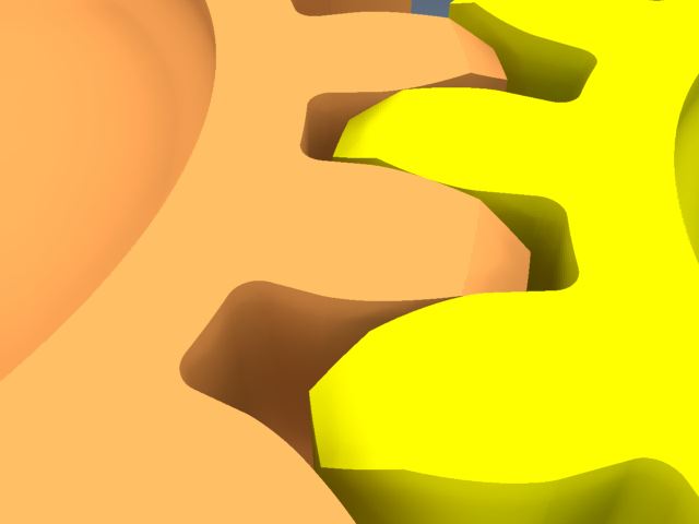

You can see an example here:
15 Tooth & 18 Tooth gears meshing
