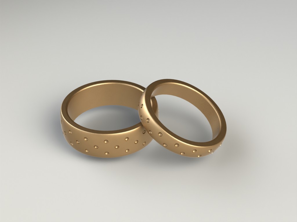

Looking to create a 'random' pattern I can then project onto a rings outer surface.
Have done formal looking ones - see pic
Now what to create a more 'random' organic look version

I've been out of touch for a while now but I think you can do this by creating points in a 3D sketch then using them to create 'Sketch driven pattern', of course the points have to be on the rings outer surface.

if this is for inventor, you can use the spline tool to create a random pattern and then use rectangular pattern on the start point, your direction will be the spline
