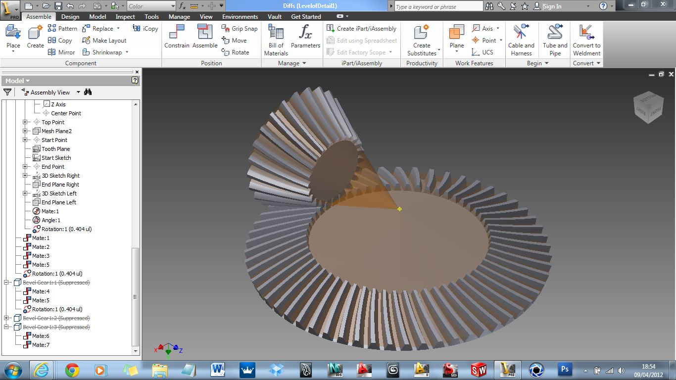

Hi Manolis thanks for the in put :)
I have got this far as you can see in the image but was wondering if it would be possible to do my simulation through the use of Dynamic Simulation? as I have never worked with Dynamic Simulation before so don't really know in's and out's of it as nothing I do with my diffs are working.... They are all working in there own Sub Assy but when I am adding them to the MASTER assy and adding other parts I am then getting errors with a lot of stuff and it is all relating back to the Sub Assy with the diffs..... Strange I know!!!
