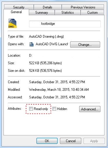

At work last week damaged the server. Today it was restored, but when you open an AutoCad file that lay on the network, gives the message «Drawing file is not valid». Before it is said that this file or is used, or only for reading. The file is not zero. Has the same size, as before crash of the server. I tried the command recover, drawingrecovery, insert. AutoCad 2008 version.
Very much I ask to help! it is a pity for the whole month of work!

you said your drawing file has file size and says that it is on read-only state. Have you tried right clicking the file itself and look if the the checkbox on attributes, read only/hidden is on/ has a check? Because it supposed to not have any box checked to be accessible.
see attached image below.
right click on drawing file and look for attributes checkbox
