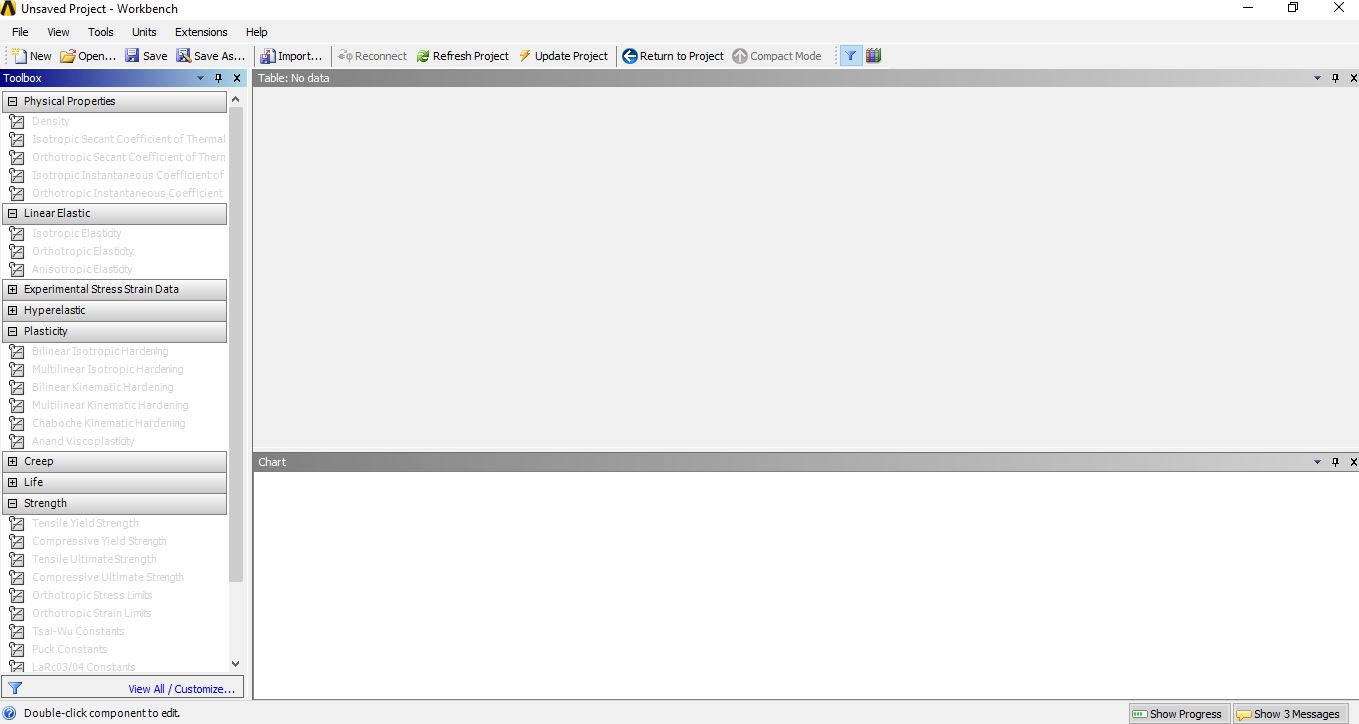

Engineering data is not populating in ANSYS Workbench
Hi, i'm facing an issue in Ansys Workbench. Upon clicking the cell to select material(Engineering Data) , the workbench is not loading an excel file with different materials and also the properties seems to be locked. I have attached a screenshot of the workbench.
Kindly Help.

hi! devaiah balluda ,
my ansys wokbanch also has same problem but I WONDERİNG if ı make your solution,AM I lost created analysis in ansys workbanch;;?
HAVE A NİCE DAY
Well ,found the solution myself. It is a trivial issue most beginners like me face in the beginning.
Go to view and select reset Workspace.
