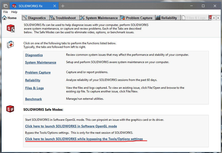

I have tried to open an assembly this morning that i have been working on for the last few weeks, and have had an error message come up saying "solidworks encountered an error opening the document. Please contact your local solidworks support representative for help in troubleshooting this problem" Does anybody have any ideas??

Open the assembly first and then try to open the drawing...
If that doesn't work then open SW RX and open with the last option
Same issue happened to me after changing the default appearance, I accidentally changed it to an appearance that I deleted from its original location. My problem was fixed by doing the following;
- Open Solidworks as normal
- Before you open any parts, assemblies or drawings just go to the appearance manager located on the right panel that has an icon with colourful ball.
- From the Appearance Manager, right click on any default appearance and select set as default appearance.
-Restart Solidworks and it should be working.
I hope this helps someone.
