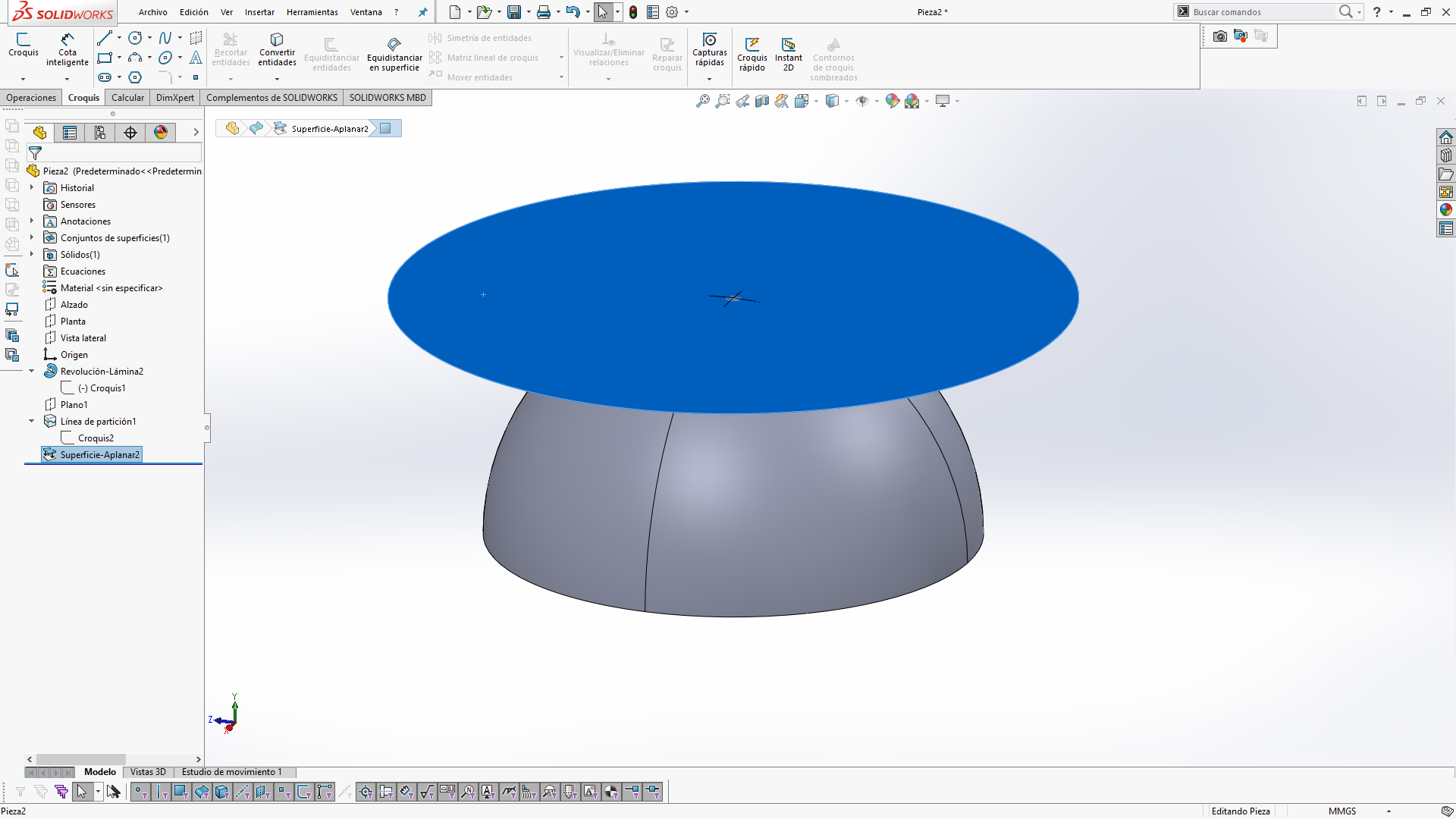

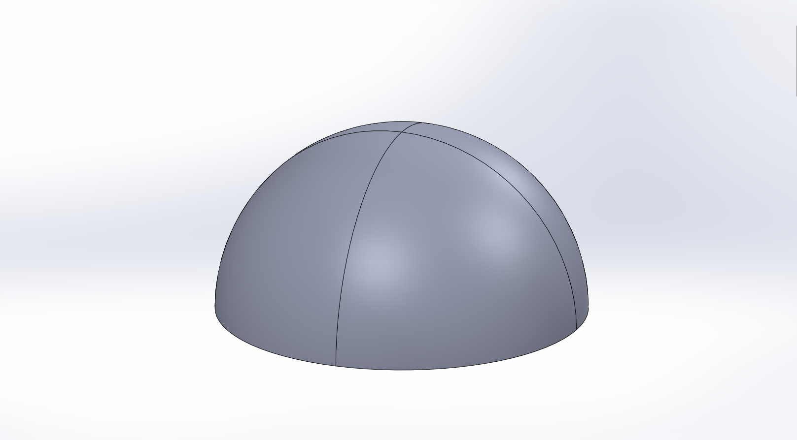

it would be nice to have some image of the spherical surface you want to develop (flatten). Precisely, in theory, the sphere is not flattenable (which you can see on a map of the planet earth, which does not develop as a single surface).
However, it is possible to make some approximations based on triangular meshes on the sphere that can be developed (flattened on a circle, for example).
In the figures I show the case solved in SolidWorks because I don't have Inventor installed, but I assume it has some command similar to "flatten surface" available in SolidWorks.
Best regards
