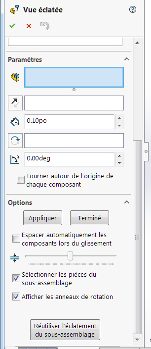

I have an assemly with an exploded view. This assembly i put in a larger assembly so that it becomes a subassembly. Possible to enable the exploded view of that subassembly in the larger assembly?

See "reusing the bursting of the subassembly" below in the Property manager "Exploded view"
I should use the feature re-use exploded view- can't find that though.
But found another way, so no answer is needed really.
