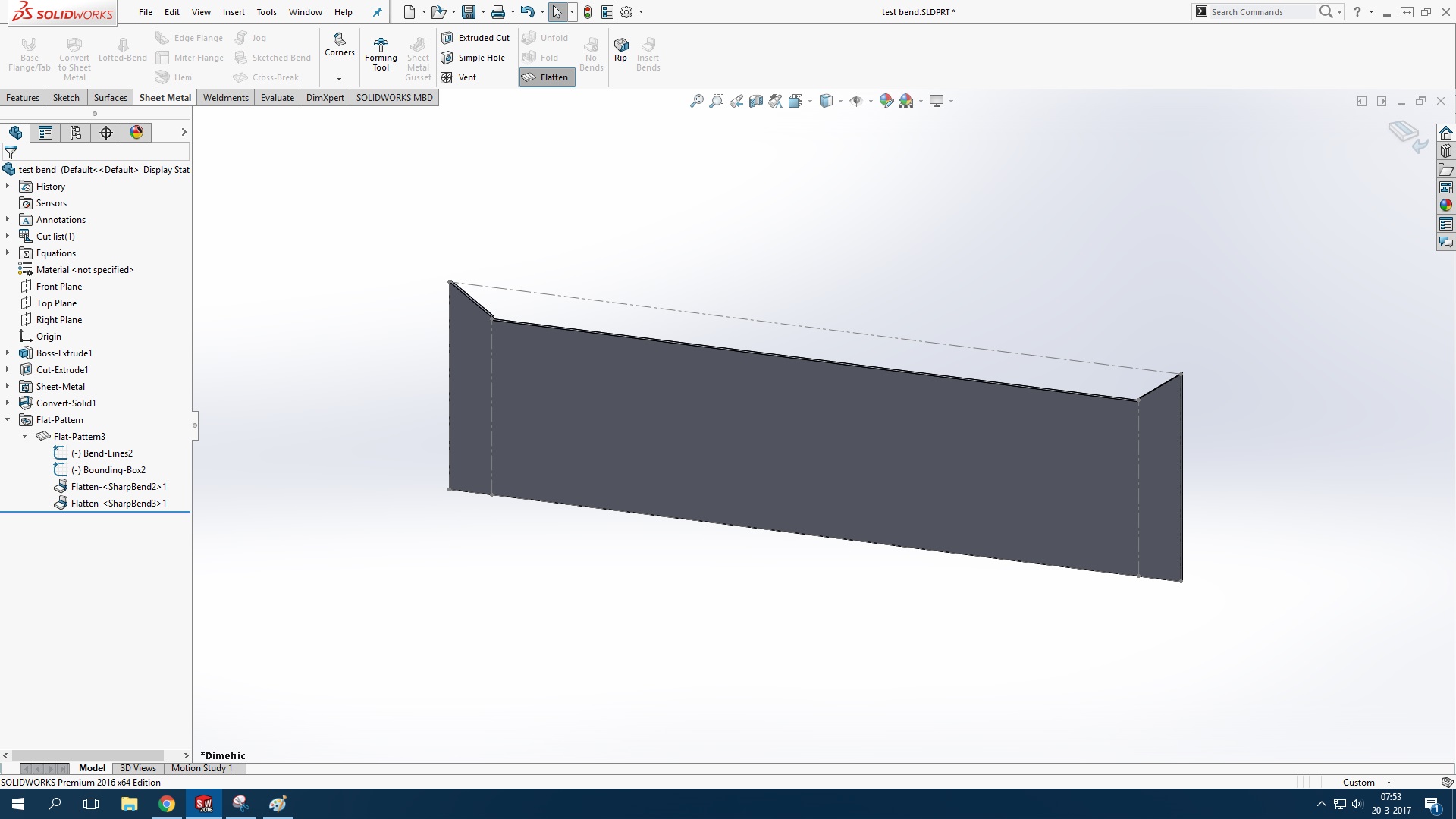

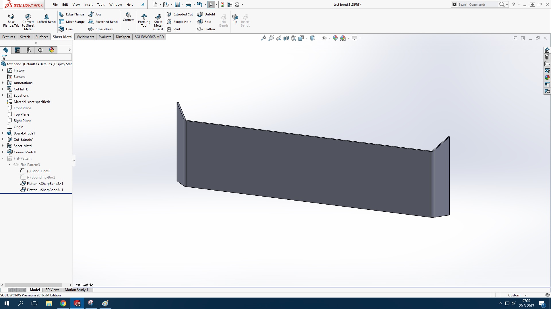

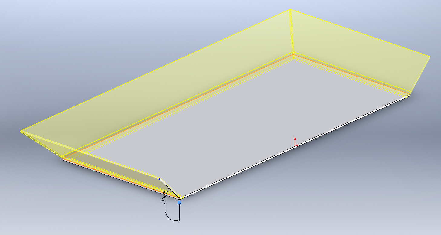

Recently I had to design something in solidworks in sheet metal, but somhow my solidworks doesn't want to make a flat pattern.
This problem didn't occure in the past, only recently, does anybody know what could be the cause?

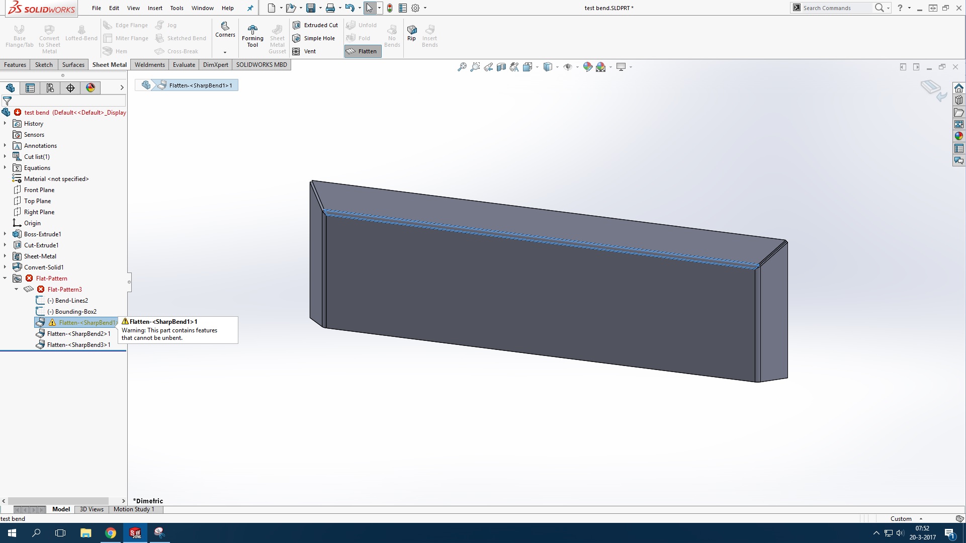

I added a test part with the desired bends in it, but the flat pattern wont come out and if I only add one bend in it, the flat pattern will be wrong.

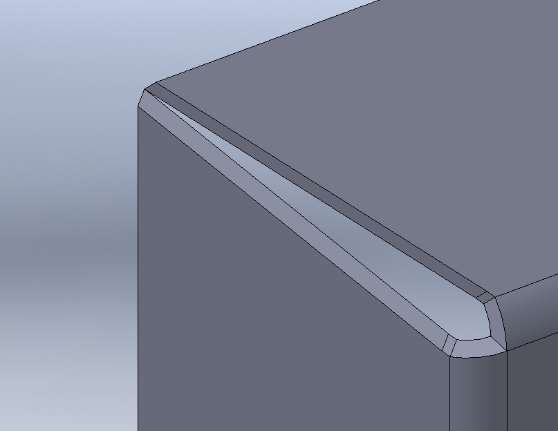

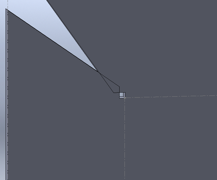

I've inserted the convert solid again and found a problem in the corners.
At the sheet-metal feature, check auto relief, 2mm obround.
Unfold, select face and bends
Make a cutout at the corners so that the plat does not intersect itself

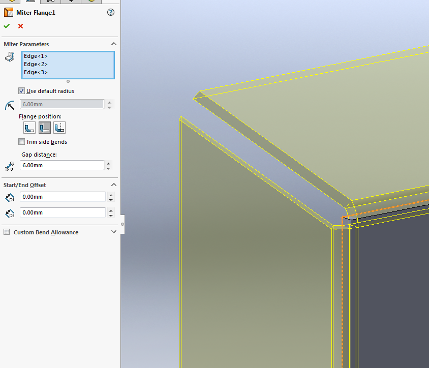

You began with an block and after that you made your part sheet metal. What you should do is start with a base flange, and then make a milter flange under the angle what you like (select 3 edges at the same time).
You will have more sheet metal features in this way.

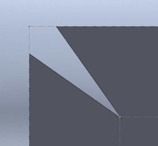

I tried it with the mitter flange but as you can see in the file below it doesnt work

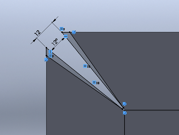

the problem is that the plate intersects itself. At the milter flange feature put the gap distance at 6, after that unfold, draw a tab (play with the dimensions, i've tried a little but its not perfect.) and fold to close the gaps.

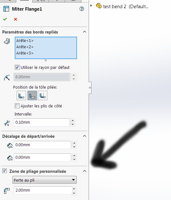

Try using the correct "custom folding area". Or reduce value of "loss to fold"pict 2. (google translate sorry)
